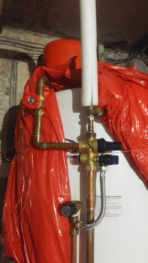

Update: had the new PRV fitted and the hot water flow is massively improved. Cold seems to be as is
But there's another tank connected to the PRV - looks like some sort overflow that has about 20 - 30 litre capacity. We emptied that out as well and it was full of dirt and sediment. Is this something that needs to be serviced every so often or is there a bigger problem?

Its the expansion vessel in red. Plumber says that ideally it should be a white one and not a red one, as red is for central heating
My worry is it was full of what looked like sludge. Plumber said its normal, but I have a doubt in the back of my mind
Its difficult for me to imagine an EXV on the water to be sludged up. Thats usually a problem on the heating circuit.
Also slightly unusual to try to open them too!

Especially when it is part of the un-vented hot water safety control system. Who removed the EV? Hopefully they are qualified - G3/UVHW Certification?
Red is for central heating and may be made of materials that are not WRAS approved and therefore should not be used on potable water supplies. Who installed yours as they may have used an old spare they had, with sludge included, rather than supply the correct one?
White or blue for potable water only.

Lord - You mentioned this tank and it's connected to the PRV, this is the pressure reducing valve you are talking about? Can you post a pic of the setup??
OK, here's a pic. The red vessel is in the background at the top of the pic.
The pipe coming out of the PRV on the left and going to the red valve is the one that goes to the red vessel
Well it should be. Red vessel indeed looks like a heating one.
Can't remember previous posts - is this an OSO cylinder with an internal air bubble.
That red valve is on the balanced cold draw off from the Safety group.
