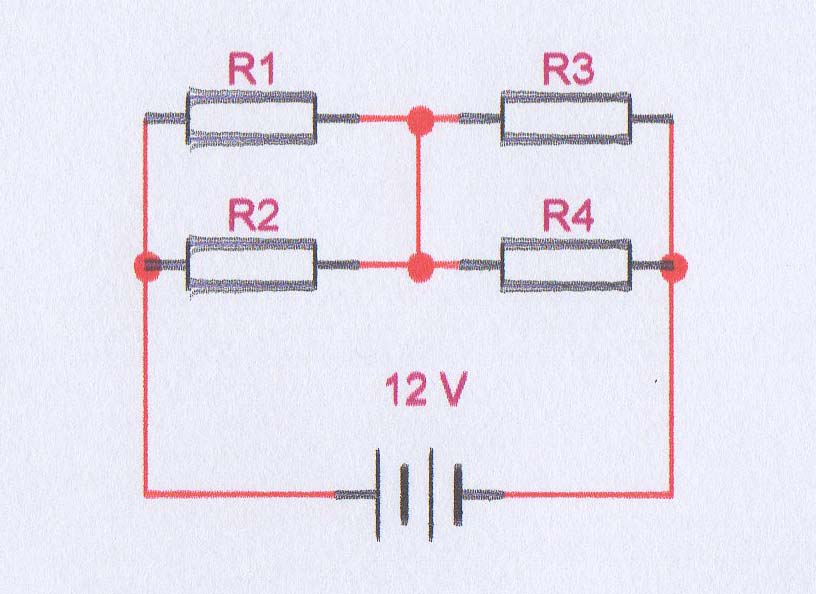

wiring 2 loads up in in parallel to drop voltage (ed: he means in series)
BTW it is 2 times LED lamps I want to wire up to a car battery. The LED lamps take 4 AA batterys (so 1.5V times 4= 6V each)

If the two loads are different, then they will share the 12V unequally (e.g. one might get 8V and the other 4V).

If you have two resistances in series then put a voltage across them they will draw current according to the total resistance of those resistors combined.
If those resistances have quite similar values then they will quite similar voltages across each one (approx equal to half the total voltage applied across them).
If, however, their resistances are more unequal then the voltages across each one will be more unequal too but the current drawn by them will be the same as each other.
So engineering tolerances and other variables make each resistance not quite the same but when doing calculations we might ignore those differences if we consider them to be quite small depending upon how we want to use them. If the differences are relatively not quite small we might want to re-evaluate the voltage differences produced.
It just depends on how much difference we might expect it to make to our finished result and what effect it might have.
If two resistances are connected across the voltage in parallel then the opposite happens - each resistance will have the same voltage across them but each will draw slightly different currents thru them in accordance with their resistance differences. Again we evaluate if that diffence needs to concern us.

If each string of LED elements has it's own resistor and the strings are supplied from a stable 12 Volt supply then open circuit failure of one string will not affect the voltage supplied to other strings. Short circuit failure of one or more LED elements in the same string will result in increased current through the resistor in that string. It may result in the resistor overheating and failing. The increased current load on the power supply may result in the supply being overloaded and it output voltage dropping,
We are discussing two (or, possibly, more) strings
in each 6 V "device"
with the "strings" in each 6 V "device" connected in parallel
but
with the two 6 V "devices" connected in series,
across 12 V .
One may have a "failure" of one "string", causing the problem.
Consider the situation below
If there are Four equal "Resistance" Strings
connected in "Series/Parallel"
with R1 and R2 being the "LED Strings" in one Lamp
and
R3 and R4 being the "LED Strings" in the other Lamp.
Normally, there will be 6 V across all resistors.
However. if R1 "fails" (Open Circuit)
the Voltage across R2 will increase (to 8 V)
and
the voltage across R3 and R4 (in parallel) will decrease (to 4 V.)
