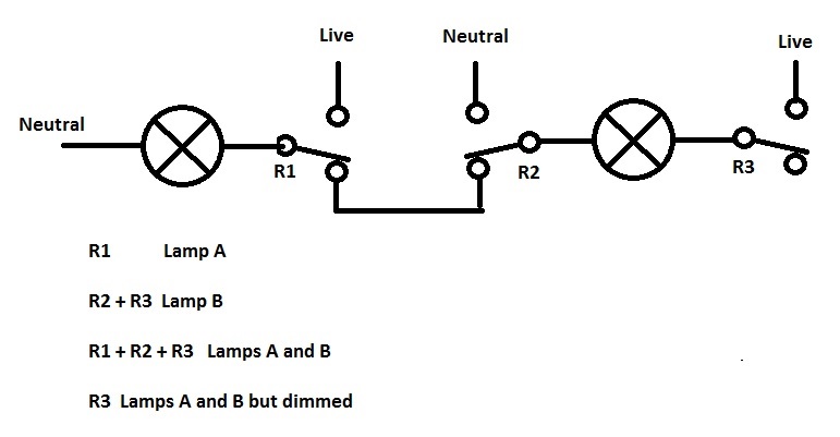

Most of my lamps are filament and wired in pairs to enable them to be dimmed by powering them in series or individually switched to be bright.
Provides a soft warm glow when dimmed.

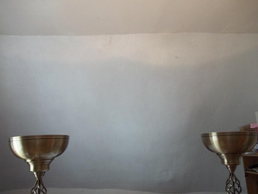

A single point source of light, will cause hard shadows, two points of light help, as will having the light fall on light coloured reflective surfaces. Generally the worst possible type of light, are spotlights, shining down from a low ceiling, with lots of dark surfaces.
Uplighters shining onto a white ceiling give superb shadow free illumination of a room, especially when the light source(s) cannot be seen.
Floor standing uplighters in my room ( which has a part sloping ceiling )
Uplighters shining onto a white ceiling give superb shadow free illumination of a room, especially when the light source(s) cannot be seen. Floor standing uplighters in my room ( which has a part sloping ceiling )

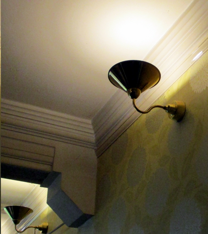

Indeed so. As you say, it's most effective if the light sources can be fat from the ceiling and 'not visible', but that's often not practical, but even with visible ones fairly close to the ceiling it can be pretty effective. I've probably posted the below piccie before, showing the situation in my living room. There are eight of these uplighters (four on each of two opposite walls), with 8 x 5W LEDs (previously 8 x 25W golf balls), and it provides a very reasonable level of shadow-free background lighting.
When addition light is needed for activities such as reading etc., this background lighting is supplemented by things which I still call standard lamps and table lamps ;)

Most of my lamps are filament and wired in pairs to enable them to be dimmed by powering them in series or individually switched to be bright. Provides a soft warm glow when dimmed.
Yes, you've shown that before, and it's an interesting approach. It obviously may, or may not, work with LED 'lamps', but I suspect it probably would with the cheap ones that simply have a 'dropper capacitor' to control current.
Technically, I imagine that, with the two 'lamps' in series, between them they would probably consume a fair bit more power than one might 'expect' if they were 'simple resistive loads' (i.e. one quarter of the power they would consume in parallel), since the filaments would be much cooler, hence lower resistance, than when fed in parallel. Conversely, I would also suspect that the total light output (with 'lamps'in series) would be less than one might 'expect' (if one didn't think too deeply), since light output from an incandescent bulb falls far more than 'linearly' as one reduces voltage - indeed, the light output will fall to zero when the power dissipated in the filament falls to the level at which the filament no longer 'glows'.

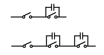

In another 'lateral thinking' approach (with LED 'lamps') which I have mentioned before, in a good few places in my house I have replaced single SP light switches with 2-gang (for two light levels) or 3-gang (for three light levels) ones, switching one or two capacitors in series with the 'lamp'. The values of the capacitor(s) are obviously specific to a certain 'wattage of LED and, as above, this approach probably only works when the LED 'lamp' uses a simple 'dropping capacitor' to control current - so I use the cheapest and nastiest ones I can find with such an arrangement.
