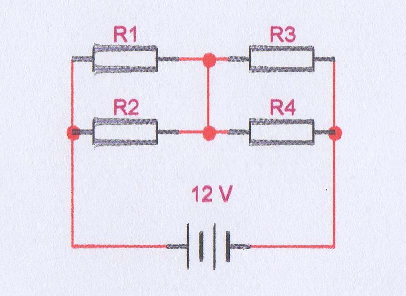

wiring 2 loads up in in parallel to drop voltage (ed: he means in series)
We are discussing two (or, possibly, more) strings
in each 6 V "device"
with the "strings" in each 6 V "device" connected in parallel
but
with the two 6 V "devices" connected in series,
across 12 V .
One may have a "failure" of one "string", causing the problem.
Consider the situation below
If there are Four equal "Resistance" Strings
connected in "Series/Parallel"
with R1 and R2 being the "LED Strings" in one Lamp
and
R3 and R4 being the "LED Strings" in the other Lamp.
Normally, there will be 6 V across all resistors.
However. if R1 "fails" (Open Circuit)
the Voltage across R2 will increase (to 8 V)
and
the voltage across R3 and R4 (in parallel) will decrease (to 4 V.)

Do you mean if one load has more amps then the other?
How exactly can two loads in series have 'different amps' flowing through them? :)
If you have two resistances in series then put a voltage across them they will draw current according to the total resistance of those resistors combined.
If those resistances have quite similar values then they will quite similar voltages across each one (approx equal to half the total voltage applied across them).
If, however, their resistances are more unequal then the voltages across each one will be more unequal too but the current drawn by them will be the same as each other.
That's exactly what I've been saying.
So engineering tolerances and other variables make each resistance not quite the same but when doing calculations we might ignore those differences if we consider them to be quite small depending upon how we want to use them. If the differences are relatively not quite small we might want to re-evaluate the voltage differences produced. It just depends on how much difference we might expect it to make to our finished result and what effect it might have.
Exactly. Again, I have essentially implied that.
If two resistances are connected across the voltage in parallel then the opposite happens ....
Yes, we know that, but it's not what we're talking about.
I think I must be missing something, since you don't seem to be saying anything that I (and others) have not already said and/or implied.

What you say is strictly true but, as I've implied, if it were me I'd probably first try the simpler/cheaper approach of just putting the lamps in series - and I strongly suspect that that would work fine.
Kind Regards, John
Forgot to say; I only bought the one lamp. But there where lots in stock so when I go to Aldi Friday I will buy the other, if there are no objections to this not working
