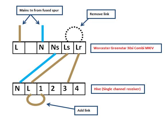

Hi, I've just wired in my hive using this diagram (attached I hope). All lights are on and nothing has blown so I think I've wired it in correctly. Just wondering how you removed your old rotary RF thermostat? I think its overriding my hive and id like to remove it! Any help much appreciated :)

This looks like a similar problem to what I have. I replaced my Honeywell thermostat with the hive receiver.
Green lights are on the receiver and hive thinks it's working, however the boiler isn't coming on. I've put the manual timer on my boiler to on constantly so this shouldn't override.
I've only got 3 terminals perm live, perm neutral and heating on connected. Do I need a little single cable to connect perm live to common?
Thanks in advance,
Ben
Hi Bbben and welcome to the forum.
If the Honeywell only had three wires connected (not counting an earth) originally, then yes you do need a link between 'live' and 'com'.
The 'com' and 'heating on' are just a voltage free switch, so you need to apply voltage to the 'com' for it to switch to the 'heating on'.

I found this as I'm looking to change out my Altec thermostat to a hive controller and having done a little bit of electrical work before thought it cant be that difficult to change over.
Hopefully attached should be a rather crude drawing of how my current thermostat is currently connected up. For the avoidance of any doubt could someone please advise which of the drawings on page 1 of this post I should follow?
Thanks in advance.
In that case, and as the terminals are marked the same for both thermostats, I'm a bit surprised you need to ask.
First and foremost, you will need the Single Channel Version of the Hive.
N and L are the Neutral and Live, so the same for both Altec and Hive.
Altec NO = Hive NO, heating on (terminal 3)
Altec COM = Hive Common (terminal 1)
