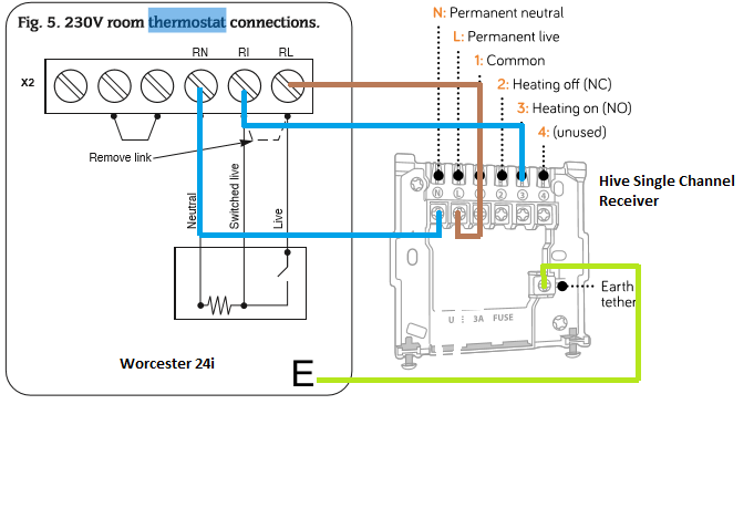

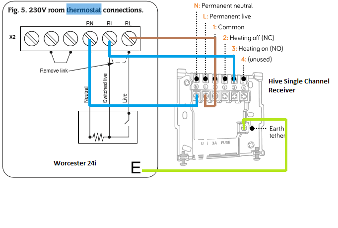

In that specific example which was answered over 5 years ago, yes they do need to be connected. If they were not, it would not work.
However that may not apply to your installation or others as different boilers are different.
