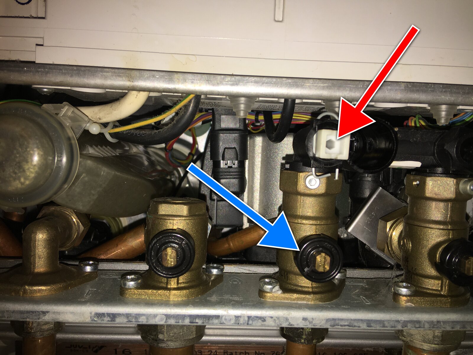

Do I need to take a photo from the underside of the boiler or where the pipes go up the wall.
Where the pipes enter the boiler,there are isolation valves. The cold feed is 15 mm.
See the attached photo.
The red arrow is where I would top up the boiler when the gauge reads low.
So I assume the blue arrow is where I turn off the water ?
If that is correct do I need to switch boiler off at the wall ?
I assume I then turn on hot tap in bath and advise if water is still flowing or not ?
Please advise & I will continue.
Yes ,the blue arrowed valve isolates the cold water feed.
Yes ,turn electric supply to boiler off.
Yes,turn bath hot tap on.
Ok
With the above done there is cold water coming out of the hot tap in the bath.
