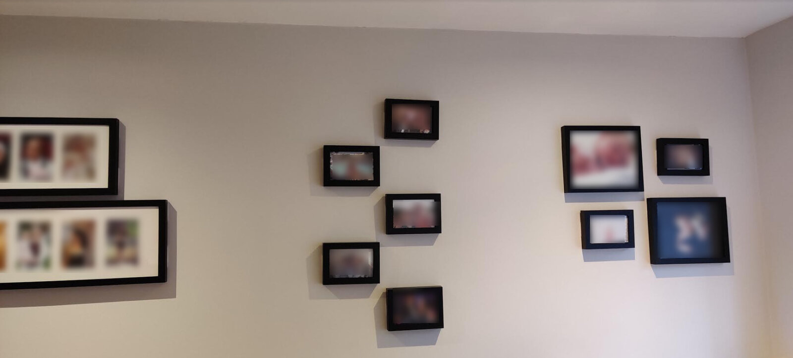

I've noticed on the photo that it looks like they chipped away at some of the brick work on the column so cabling could well be deeper that most of us first thought.

I put up a load of pictures about 4 years ago. But I was in a rush so (luckily) used CommandStrips (I know, I know - but I had to put up 27 picture frames in an hour or so, and it had to be quiet) - whereas I typically prefer the sturdyness of a rawlplug and screw in the wall. (You'll see a strip of frames, pretty much where the column/pier is....)
More likely, the cables have gone into that channeling and the plasterboard is flush against the brickwork - so the cables are only the thickness of the plasterboard and skim deep, or around 15mm.

The corners of the pier were chipped off by the electrician to stop the cables going over a sharp corner - there isn't a channel in the brickwork sadly.

The picture isn't clear enough to tell for certain. But there's stitch drilling and between the rows of holes the brick looks different to above and below. From that picture, it certainly looks like it's been chased - inline with where the cable would be if they weren't sagging between supports. Even if it's not chased, the cables will be just behind the boarding with minimal gap.
Of course it's possible that the sparky screwed a plate of steel over the cables before they were boarded over ... But then some poeple claim that there's a porcine aviation display team :whistle:
