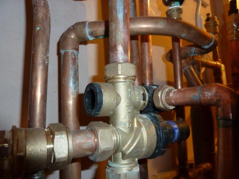

I have tried hard to be fair to the man. I bent over backwards to give opportunities to put things right. I overlooked the fact that he lied to me about condensate (I was planning to redo it internal myself when he'd cleared off). When I first noticed and asked him about the arrow on the Fernox he lied to me again and I decided I'd fix it myself when he cleared off. I was unhappy about the messy install, but I was worried about the pump running continuously. So I started this thread.
I was advised multiple times in the thread to kick him off the job before I insisted with the builder that I wanted things re-worked. Still I didn't insist the plumber be sacked. I accepted that he would do the re-working.

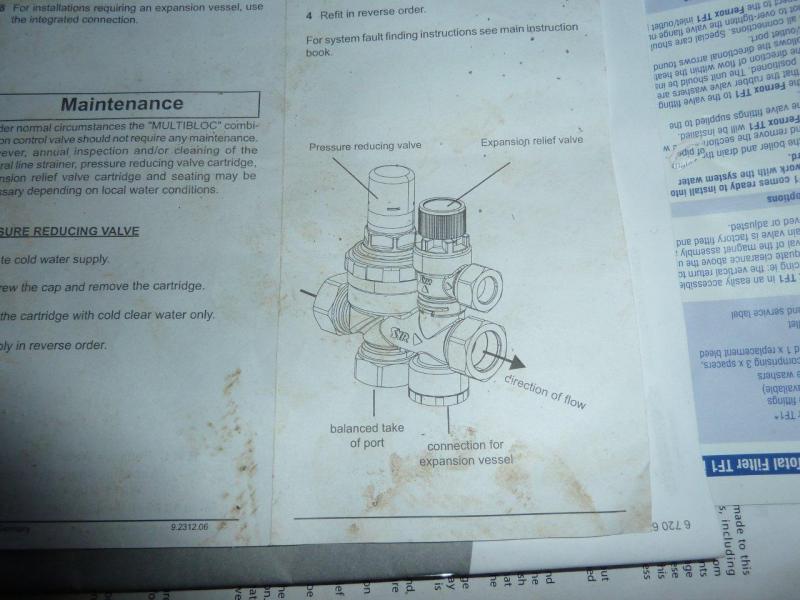

I didn't even insist the plumber be sacked when he told me explicitly that the expansion relief valve was not a relief valve and could not discharge water under any circumstance, just before it discharged water all up the back of the cupboard.

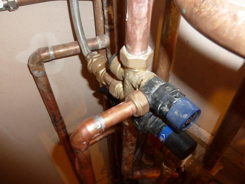

I sacked him at the point he installed an unvented cylinder with no useful expansion vessel and told me it was a complete and safe install. Do you really think I should sit back and say nothing when a 'professional' installs an unvented cylinder with no expansion vessel? It's OK to do that if a professional does it, is it? Or do you think I've photoshopped all these pictures as some sort of bizarre vendetta against someone I'm taking care not to identify in public?
I think I've gone way beyond any reasonable measure of giving the man a fair chance to sort things out.
You will also recall what started the thread - I didn't say anything like 'this imbecilic cretin has done it all wrong', I said (and this is a direct quote "maybe I'm wrong and he's right, so I'd welcome views about how concerned I should be".
The answer was actually, about ten times as concerned as I already was at that point.
Just to be clear - because I do take care to be fair to people - it's not a rant directed at easyflow singular 'you', but to the plural 'you' being all those that think the ignorant punter should stay ignorant and silent, even when the 'professional' is being potentially lethally incompetent.
If whoever turns up to fix it also connects the combined inlet group with the expansion vessel on the balanced pressure cold port then yes I will question it. Who really thinks I should instead let it ride?

Just to be very clear here. The plumber has told me this is a complete and safe install. Should I believe him?
I'm not trusting the builder, I'm trusting my ability to read simple clear instructions.
