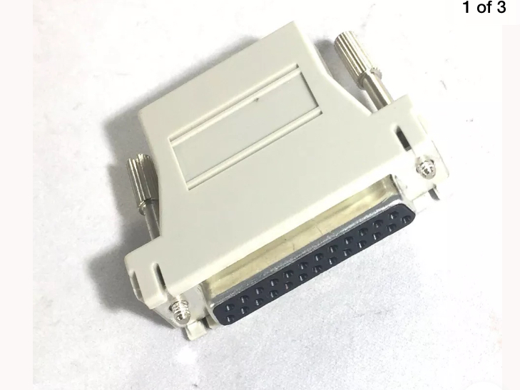

Well it needs to control 9 leds, so yes, it needs a min of 18 pins. IP55 rating would suffice, and there is less than 1 inch of space available (length) I think a MIL connector will suffice, seen some that look potentials, but needless to say, expensive.

Why does 9 LEDs need 18 pins - would not 10 be adequate (1 common plus one for each LED)? Anyway, what I was asking was whether there was not any other space, anywhere, given that a 1:10 car is hardly a 'matchbox' model!
... and do you really need IP55 - after all, that's more than would be required in, say, a bathroom.

Hmm, hadn't thought of that, so maybe only 10 pins required. Yes, it goes in the sea. (shallow part) and whilst 1:10 is not tiny, even to make space for the light controller, the normal setup has to be modified to make space.
If a DB25 connector is too large, would splitting into two DB9's work?
A bit of work with adhesive lined heat-shrink sleeve should help with the cable integrity.

Indeed, as I said. In fact, do you really have 9 LEDs which all need to be independently controlled? On a full-sized car, virtually all of the lights come on in pairs (or even triplets). If your '9' include any pairs (or triplets) which always come on together, then you could reduce the number of pins even further.
Yes, it goes in the sea. (shallow part) ...
Fair enough - that's rather more dramatically 'off-road' than I had envisaged :)
