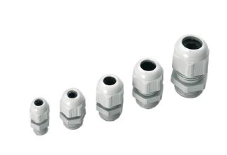

Use the right size of one of these to fit the cable you use - and you can use your original 18 cores then :)
far too big.
There are smaller versions available. For example, if you look (here) , it looks as if the smallest requires a 12.7mm diameter hole (and may be as cheap as 28p).
Kind Regards, John
