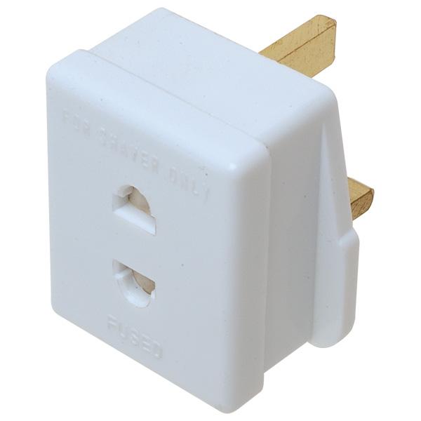

http://www.rapidonline.com Order Code: 23-0300
Shaver adaptor, Fused Type, 230V Voltage Rating, 13A Current Rating, A 13A Plug Style Adaptor for 230V, Electric Shavers, Electric Toothbrushes, and other Low Power Appliances, Which have 2 Flat or Round Pins, the Adaptor is Approved to BS1363/3 Fitted with a 1A, 20mm Fuse
•The adaptor is approved to BS1363/3 fitted with a 1A, 20mm fuse
•For suitable replacement fuse, see order code 26-2475, in Fuses & circuit breakers section
A bit chunky maybe but well made and properly fused.
Bernard, I've got one of those, but find it a rather unattractive feature :( I've tried hiding it under a towel, have painted it, have put a vase in front of it and tried it in several different sockets around the house. Alas, it jars aesthetically and has to go :mrgreen:
