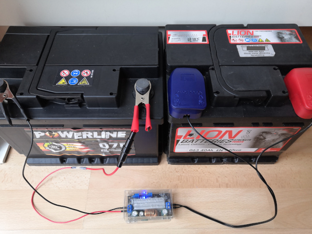

This battery project is taking an exciting turn in direction. Rather than attempting to revive batteries, a better solution is to prevent batteries falling into a poor state. This can already be done by swapping out batteries. But I found that to be tiresome. So the solution is a portable charger. In this prototype, the smaller 063 battery is charging the bigger 075 battery:
With a portable charger, there is not the hassle of mounting and unmounting a battery from the car. The charger will plug into the car and go. The charger will run the sleep mode power requirement of the car as well as charge the car's battery. Once depleted, the charger could be removed from the car with minimal effort. The charger will only be needed in low light seasons where the solar panel becomes useless.
During the prototype test. It was discovered that the capacity of the 063 battery increased from 248CCA to 255CCA during a 2 hour discharge. This proved that to maximise battery capacity, one or more discharging and recharging cycle was necessary.
The plan is to place the portable charger in the driver foot well. It will be taken out when driving. This is not an issue for infrequently driven cars.
The new charger controller is on way. This will be fixed in settings at around 12.8V and 150mA, and be attached to the charger battery as a single convenient package. The car sleep power consumption is less than 80mA. The excess power from the charger will charge/maintain the car battery. The actual amount of charging current will be regulated by the voltage difference between the car battery and the charger. When the difference is small, the charge current will be proportionately smaller.
Tests indicated a voltage differential of 0.05V is enough to induce charging. The gassing resulted from excessive charging at 13.5V was low. It could be even lower at 12.8V.
