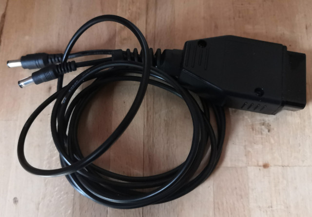

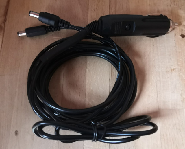

Here are two styles of car charging cables. For a car that shuts off the cigarette lighter while in sleep mode, the ODB2 port can be used. Both cables are protected by 750-800mA fuse, in additional to the car's own protection fuse. Each cable has two charging connectors, one for a perma-placed solar panel, and the other for the to-be-developed portable charger.

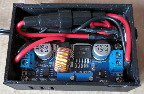

The final prototype of the charger controller is ready. The controller is protected by 250mA fuses on the power in and power out sides. This will make it safe as houses while playing with unattended battery charging. I could use lower rated fuses if I had them.

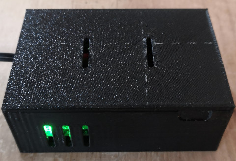

The socket is the power-in, lead is power-out, and the side air vents double up as a window to the status LEDs: blue=charging, green=full, red=amperage output at limit. I believe the LEDs consume 10mA each, and are power parasites for the car and/or charger. There are vents on the lid. I don't anticipate a lot of heat: 12.8v * 0.150A = 2W max + wastages. The enclosure is made from PETG, using a £90 new BIQU Hurakan china printer, that was on offer on ebay.

Here's the production version of the charge controller, based on the step up down DC converter I was using before. I have 3 units, 2 for in car use. Use of ethernet wires limits the maximum capability to 2 amps. For the in car units, these are protected by 250mA fuses on the supply and output sides.

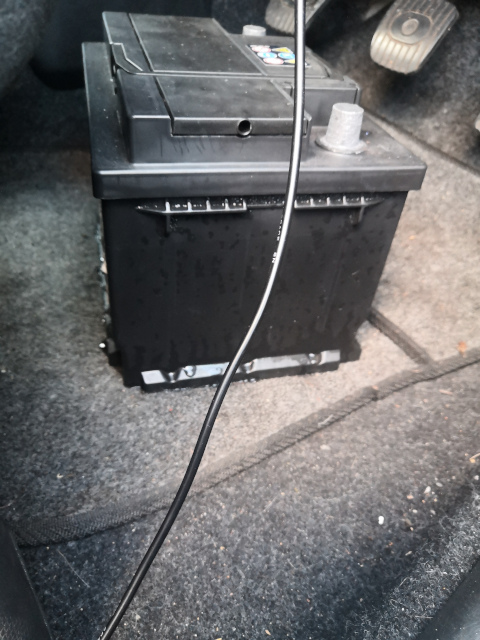

The charger battery becomes a fridge during discharge and condenses air moisture into water. This will have to be dealt with by padding it with a thick towel. Water is pooling at the base as well as on the "ledge" below the top.
To avoid you disappearing down another 'rabbit hole' - batteries produce heat, both during charge, and discharge. What you are seeing is simple condensation, due to high moisture levels, and a battery cooler than its environment. It was perhaps very cold overnight, the cold will linger, due to the large batteries mass.
