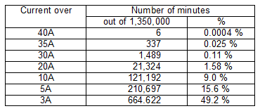

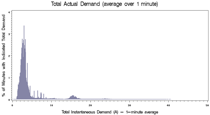

Glad you agree. It might interest you to look back to some data I presented in (this thread) , relating to the total demand of my entire installation over a period of about 2.5 years at the time (about 1,350,000 minutes). The most pertinent bits were the table below which shows that, of those ~1,350,000 minutes, there were only 6 minutes (0.0004%) when the total demand in my installation exceeded 40A, and only just over 0.1% of minutes during which the total demand was >30A

That's not unexpected in many abodes, I find that Mrs Sunray will habitually run through the sequence of washing machine, tumble drier (to soften previous days wash), dishwasher, toaster or microwave and kettle first thing. This could easily include the use of electric cooker or be at the same time as me using electric shower. I have never checked but I reckon we could easily be approaching our limit (believed to be 60A fuse as looped supply). I am concious of the limit so try to limit peak load by running dishwasher in the evening and time the shower etc.
I've just put the clamp meter on main tail; 0.32A, adding 18W of hall light so I can see meter better; 0.39A
As I've suggested, it's really a question of how long loads are very high- going beyond the CCC of cables or In of OPDs (even the cutout fuse) for relatively short periods is of little consequence.
Toasters, kettles, microwaves and even showers are not usually on for appreciable periods of time. Even washing machines and dishwashers only use 'high power' for pretty short periods, and cookers are usually very much 'up and down' with their thermostatic control. Tumble driers (and, of course, any sort of 'electric heater') are about the only common appliance which draws high current for relatively 'long periods'. As a consequence of all that, very high total loads which persist for appreciable periods (say, more than 15-30 mins) is probably pretty rare in domestic environments.
