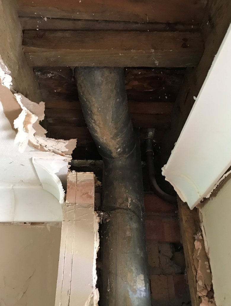

I've exposed the ceiling below and it looks like this:
There is no blanked off connector unfortunately. That elbow is the one for the toilet and the pipe also continues up for the vent (seen in the earlier picture). I was thinking of cutting it where this elbow springs off, fit a tee and then point it towards the back wall to get my floor inlet for the toilet further back. I can then add a plastic fitting which also takes my 40mm waste. I was planning to use my recip saw with a metal blade to make the cut.
Please tell me if you think that is bonkers!
have you determined yet if it is galvanised steel or cast iron?
Measure it very carefully. With luck you can get a plastic connector that will fit correctly and make a perfect seal, but check that before you start cutting.
You may need to add extra pipe clamps to support it before you start cutting.

excuse my ignorance guys but how can I easily determine if this is steel or cast iron? I just figured that it was metal!
@JohnD I own the house. It's a terraced property in a housing estate. There is no indication of it being an industrial conversion. It's built of brick and block and I don't think it has a cavity. I hope that provides an indication of age
if you can reach the top of the pipe, how thick is the material?
if you've handled both, you might tell by hitting it with a spanner or something and listening to the bong.
Try a magnet first to verify if it is ferrous.
I suppose cast iron might be galvanised but I don't think I've seen it. Perhaps I am misled by the colour. Could it be grey paint?

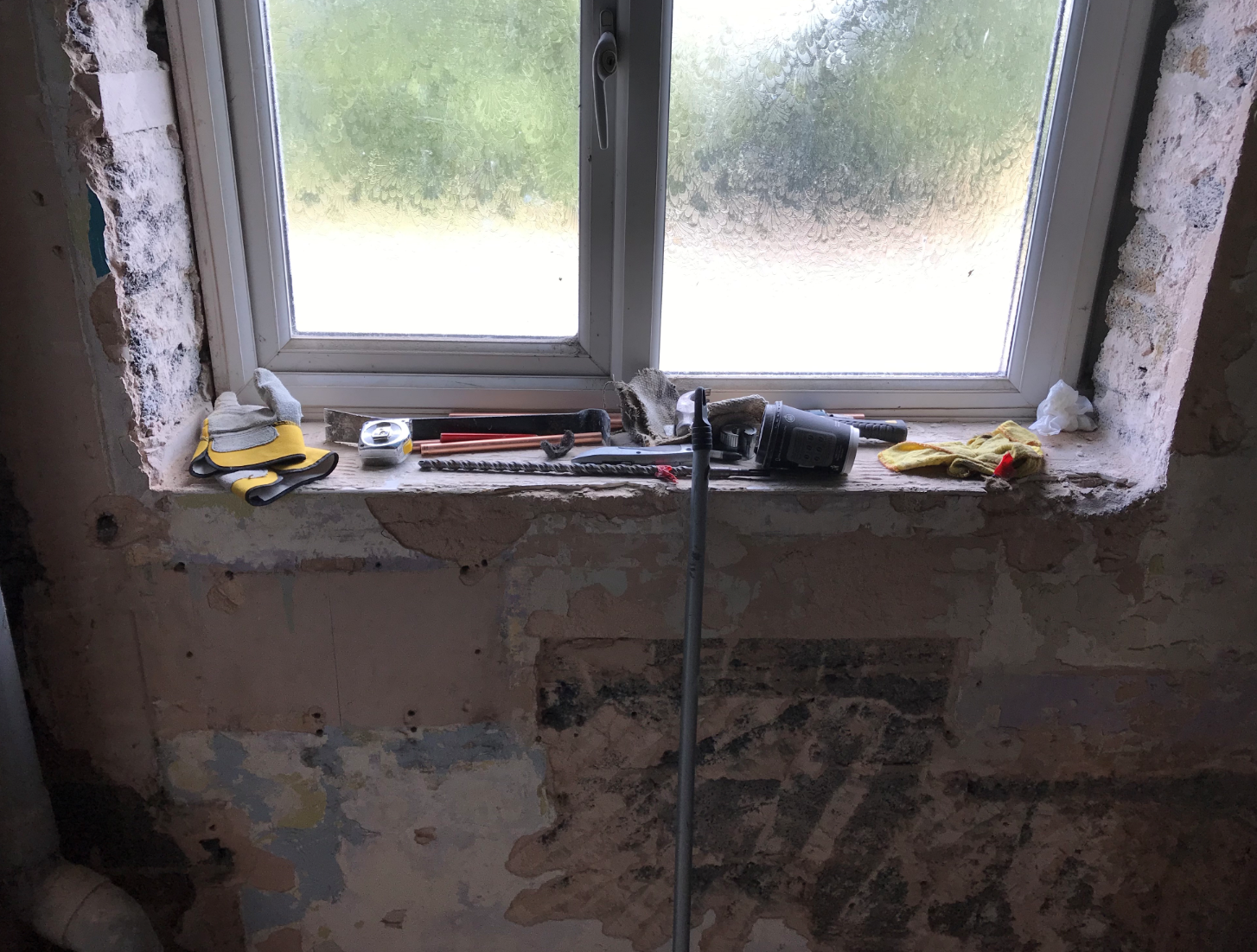

I thought this picture may help and this is where I am deducing the possibility of a cavity-less wall:
This is an external wall
Breezeblock internal wall, I'd be confident that's an 11" Cavity wall. Soil pipe, either try a magnet on it, steel it will stick, non ferrous it wont, or tap it with a hammer, lead will just 'thud' and dent. Steel will give a resounding ring and not dent unless you hit it with a 14lb Percy.
Ok guys, I have some additional info.
The external wall is 23cm thick. This excludes plaster. Also, it’s not cavity as I didn’t encounter that when drill the core hole for bathroom extractor.
The soil pipe is definitely magnetic.
The circumference of this (measured with a rigid tape measure) is 36cm.
I welcome your thoughts.
I was wondering if there were any thoughts on my soil pipe and the likelihood of cutting it and finding a suitable fitting - to eventually take the 110 plastic system.
I've never seen it and judging by responses, nor has any of the plumbers on here.
As I suggested previously, I'd be taking it apart at the current spot where it converts to plastic and examining how they did it originally. This will also give you the ID and OD dimensions which will help you search for a suitable fitting.

Mcalpine do a drain connector but it's for 110mm to clay or cast and you need to know the ID of the metal pipe you have to determine if it will work...
https://mcalpineplumbing.com/plasti...nectors-roof-flashing/dc1-blc-drain-connector
If your soil is larger then you may have to look at flexiseals or ferncos that will slot over the OD and get clamped down with a jubilee clip.
