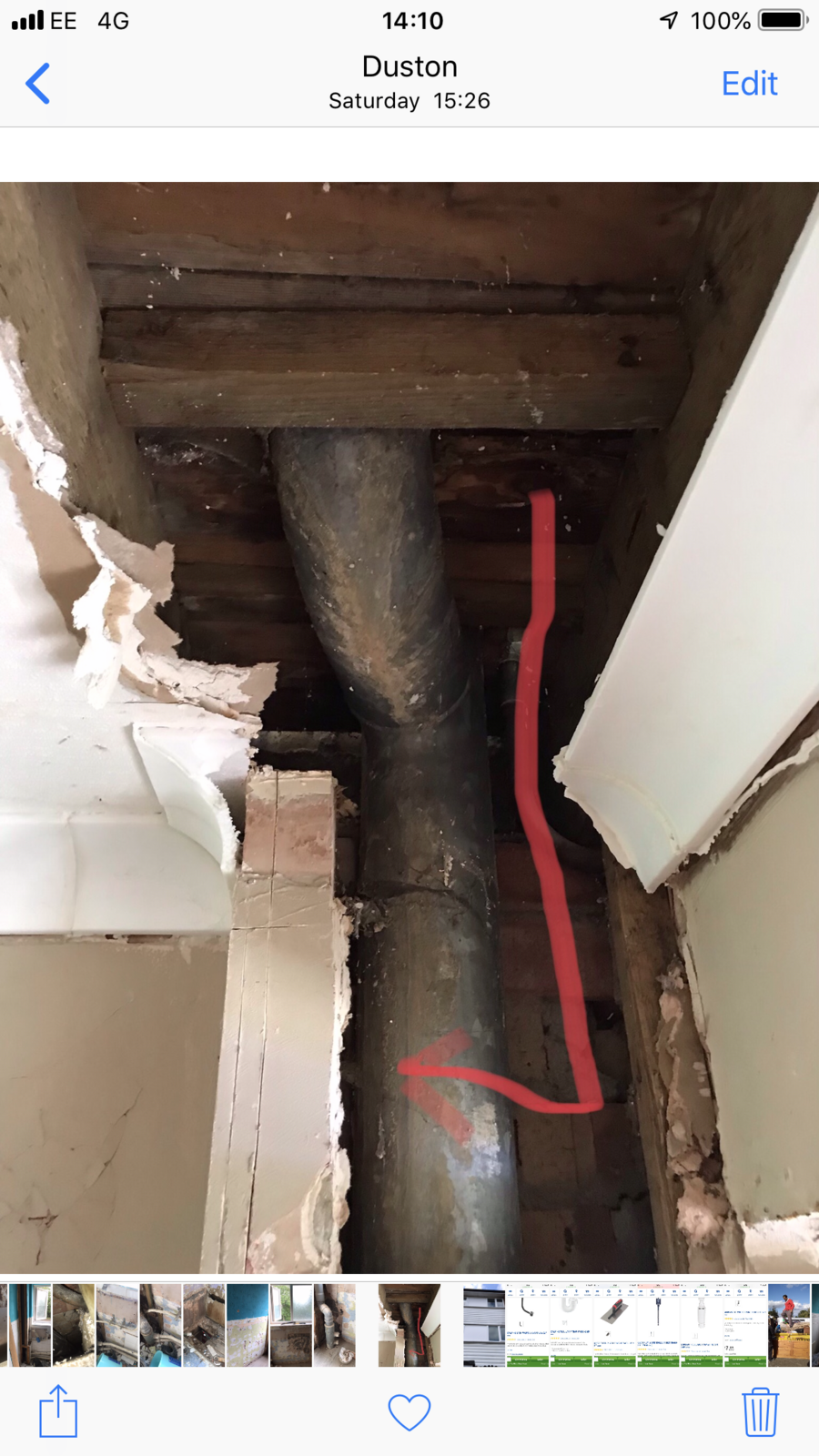

I was wondering if my circumference measurement of the metal pipes provides any indications on which fitting I may be able to use for conversion to plastic?
One further question at this point please, can I use the recip saw (with metal blade) to cut this when I am ready to do so?
Also, it may not have been clear in the pictures but to confirm - the plastic pipe is smaller than a 110mm pipe.
I will try to get some intel from a local plumbing shop too.
Thanks again

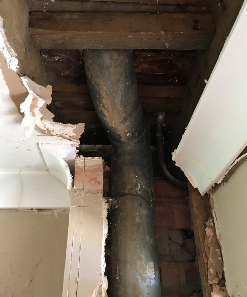

My cunning plan is to fit a plastic tee on this rubber fitting. The end going up will need to connect to the vent pipe, which is a different size (that's for another day...) but the other end of the tee will be as low as the bottom of the floor joist and point towards the bath. As a reminder, here is a photo from the floor below:

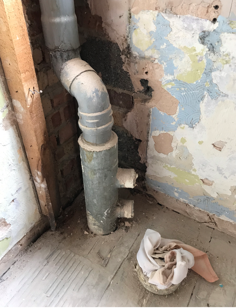

I think I will need to put a small section of pipe into this end of the tee before I fit a connection to receive the toilet waste and 40mm waste. This toilet inlet can be pushed further back towards the back wall so I can easily fit a close coupled toilet. The current inlet is too far away from the wall. Again, here is a reminder:
My question, which fitting do I put in place to receive the toilet pan and a single 40mm waste pipe?
I hope that made sense and thanks again.
Welcome to the world of concealed pipework :LOL::sick:
Cast iron in that location is best cut with some careful work with a 4" grinder and a thin cutting blade.
It has to be done in steps... Cutting a tall section off the front, with vertical cuts, as well as horizontal, to give yourself a sort of bomb door that comes away, thus allowing you to get the grinder inside the pipe to then cut away at the back. You start up high, to get all the way through the pipe and then come down in steps to end up with a clean, square cut, where you want it.

Your bath and basin waste should ideally connect to the vertical stack, separate from the toilet.
You "may" be able to do this inside the floor void AND the existing boxing by coming down the left or right side of the vertical stack and keeping it tight with a spigot elbow into a bossed branch (as shown in one of your previous images).
Or you may need to bulk-out the boxing to allow for connection of the 40mm waste, separate from the wc.
It's hard to tell exactly how to achieve this without being there and having an assortment of fittings to hand to dry plan the setup.
I'd use your local merchants and ask them if you can bring back unused fittings... I do this a lot with my shop.
I'd cut the cast low down, to get the mcalpine fitting in and then come off that with plastic before going into a solvent weld boss connector and then on to a solvent spigot branch... That way, you've dealt with the cast and can then more easily configure the plastic. (y)
The surface patern, swaging above the top boss and lack of grainy surface makes me think,its possibly galvanised steel??
Yeah. Does look like the railway fencing a bit. Either way, same procedure to get onto it as long as ID is compatible with the mcalpine coupling.
