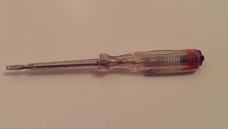

Inspired by your question I sauntered off to find my neon, now as it happens I have three :)
Two of the push-button with spring inside types and one that just has a metal cap. Now I never use them (normally) to detect electricity so for all I know, none of them work. Hopefully the following makes sense.
If I use either of the push-button types, hold it against anything metal, they don't light, with or without the button pressed in (can you tell I don't normally use them for detecting electricity!).
If I use the other one I have with a metal cap, if I hold it to any pipework, tap, unpainted radiator part, it lights brightly if I put my thumb on the cap at the top. If I don't put my thumb on it doesn't light up.
I also have one of those light-up plastic voltage detector pens, which does not light up when offered to pipework etc. I have used this before to check power to light switches and the like very reliably in the past, so I trust it... as much as I trust anything at this point!
So, on the balance of probability, three of the four devices I've used, show nothing... so why do my fingers tingle and why am I still suspicious..? :)

Is there any chance that you could post a photo of these various devices, so we're sure that we know exactly what we're talking about?

Of course, I'm grateful for your attention!! Pictures below :)
Despite all the failings of these things, that really doesn't sound right to me - what do others think?
Kind Regards, John
Bear in mind that there is a variable in the mix here, that is to say me, so if I am inadvertently going down cul-de-sacs or being a bit random, bear with me :)
Hope this works :)
Push button type
Metal cap type
Volt Pen
The top one is the dreaded neon.
The second indicates voltage when tip contacts the conductor without touching the top and continuity when touching the top.
The third is a non-contact voltage indicator.
The first is a true neon type that needs about 60 volts to excite the light.
The second is an LED amplifier design that will illuminate if you touch both ends simultaneously so require virtually zero to excite the light, hence my previous statement that they'll illuminate if they even "smell" voltage.
The last senses electrical field to trigger the light and don't even need contact with a mains voltage.
None are reliable as safe sensing/detection devices - but that's only my personal opinion.

OK - thanks. As has been observed, your photos indicate that it was not a "dreaded neon screwdriver" that was lighting up brightly on all your taps, radiators and pipes, so I can withdraw my suggestion that something seemingly very wrong was going going on. As Jackrae has indicated, the device you used which lighted up is ultra-sensitive, so it's lighting up does not necessarily indicate the presence of a significant voltage.
... which somewhat takes us back to square one, with you needing a competent proper electrician with a full set of test kit (and the knowledge of how and why to use it, and how to interpret the results) to look further into your problem

Just in terms of the screwdriver in the second picture giving a continuity test when I touch the cap, if I touch the cap and I'm stood outside the shower on a lino floor, with the blade touching the main body of the shower, what continuity am I measuring? I don't doubt what I'm being told, I just want to understand really.
My sincere apologies for the erroneous info, I assumed it was a neon like the other two...
No problem - but, just for the record, the third one isn't a neon, either :)
