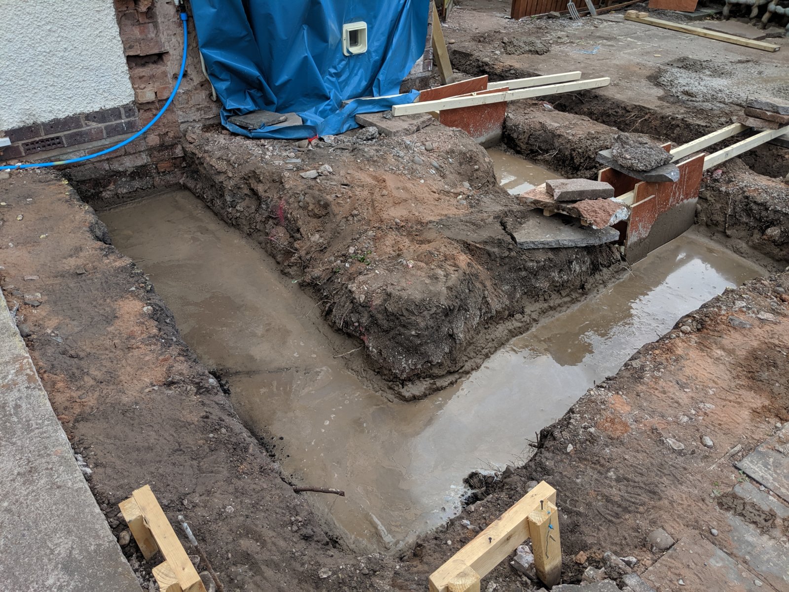

So, the concrete. In short - it didn't go great. I recorded a video and everything, but in light of what I'm going to write I've not edited or posted it. But I think it's only right to include what goes wrong on these project write-ups too.

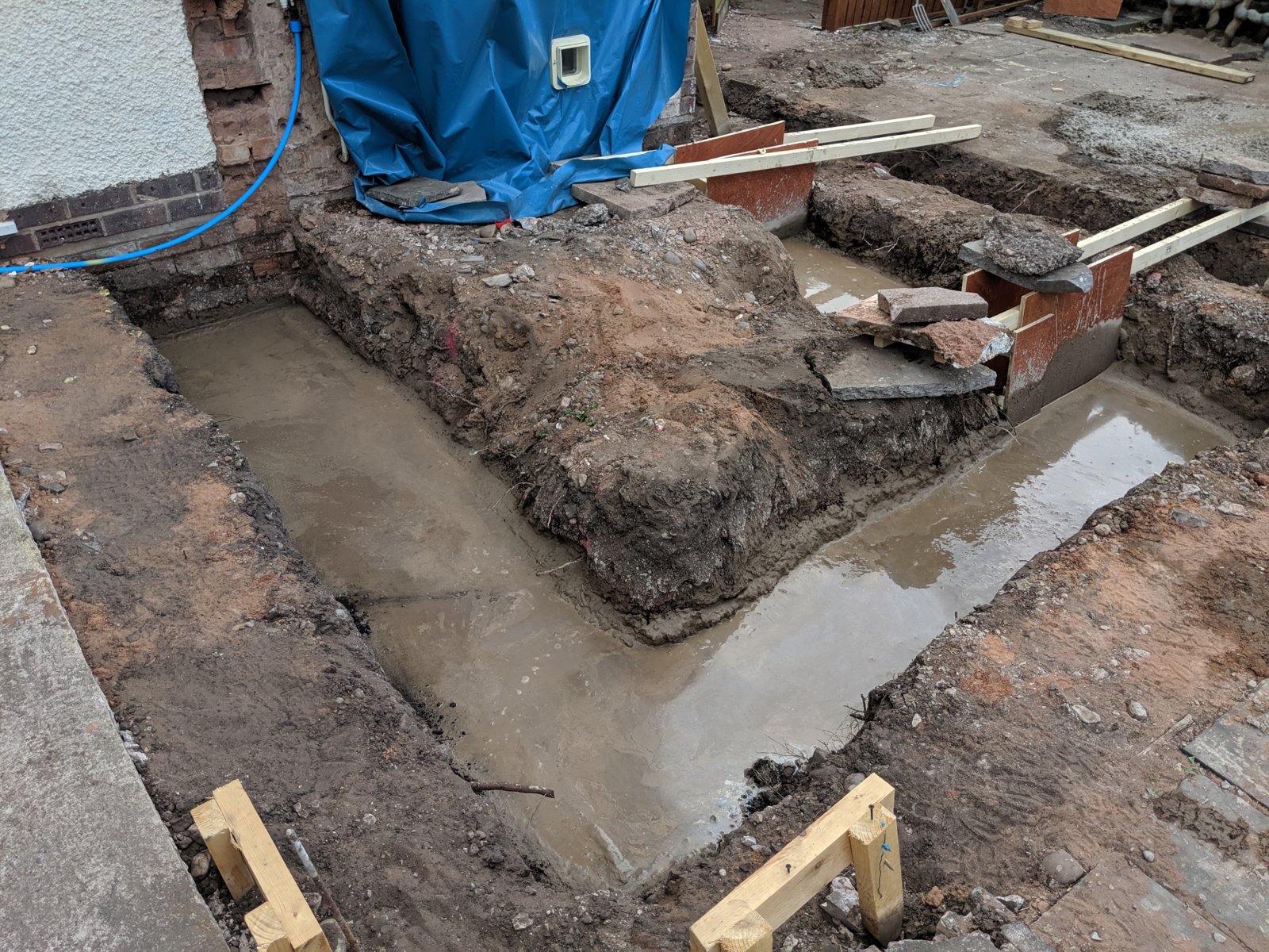

Due to various conflicting schedules and such, I was basically stuck by myself for the concrete pour. I had nobody to help me, and I was very conscious of the trench being left open for too long especially as the top of the trench was (and is) very crumbly. Because of this, I decided to speak to a few local concrete firms about pumping and while it was fairly expensive, it seemed like a sensible solution.
So, I enlisted Local Firm A who assured me confidently that they'd come and pump the concrete get it to height and I wouldn't have to touch a thing while they were there. Sounds ideal for a DIYer on their own, hey!
Well, the whole day was a s**t show really. They were many hours late due to some issue with a truck somewhere (I know that's not their fault really), but I think they turned up at past 4pm with several other jobs still to go. One of the guys was wearing sandals, which didn't exactly fill me with confidence.
Anyway, I told them to bring it to just about rebar height and for whatever reason the guy struggled with getting the pump shut off with his remote control thing. It probably didn't help that he'd decided to position himself and work around the worst bit of the crumbly bits.
Even standing well back it was clear we were well over - I tried to get some out with a shovel, but it was an exercise in futility really and I started to worry I was going to end up in the trench! So all I could do was tamp it the best I could.
To be absolutely honest, I felt damned deflated after this but all we can do is fix forward!
And hey, I've got a trench full of concrete! End result was it was about 30-40mm over where it should be

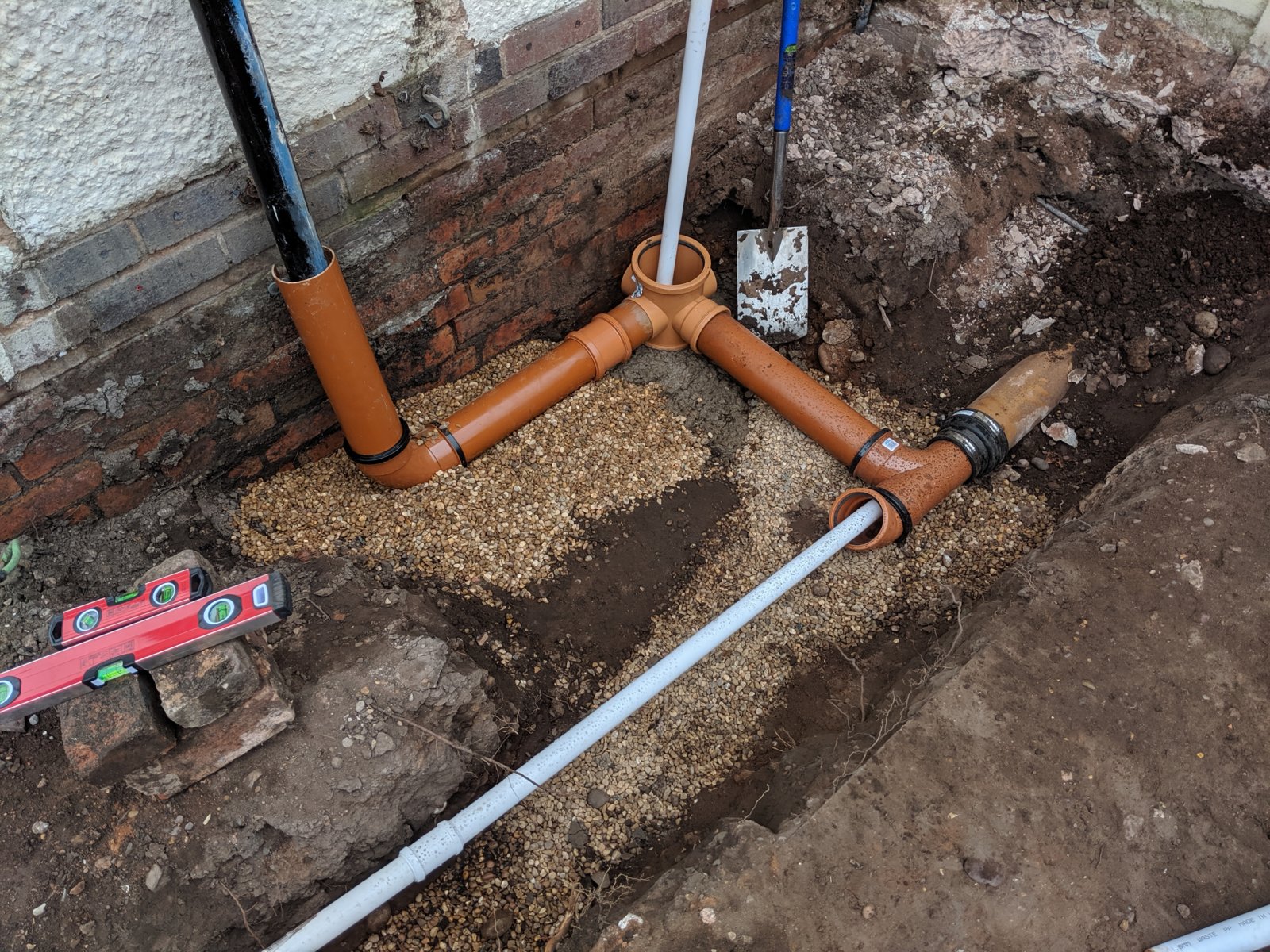

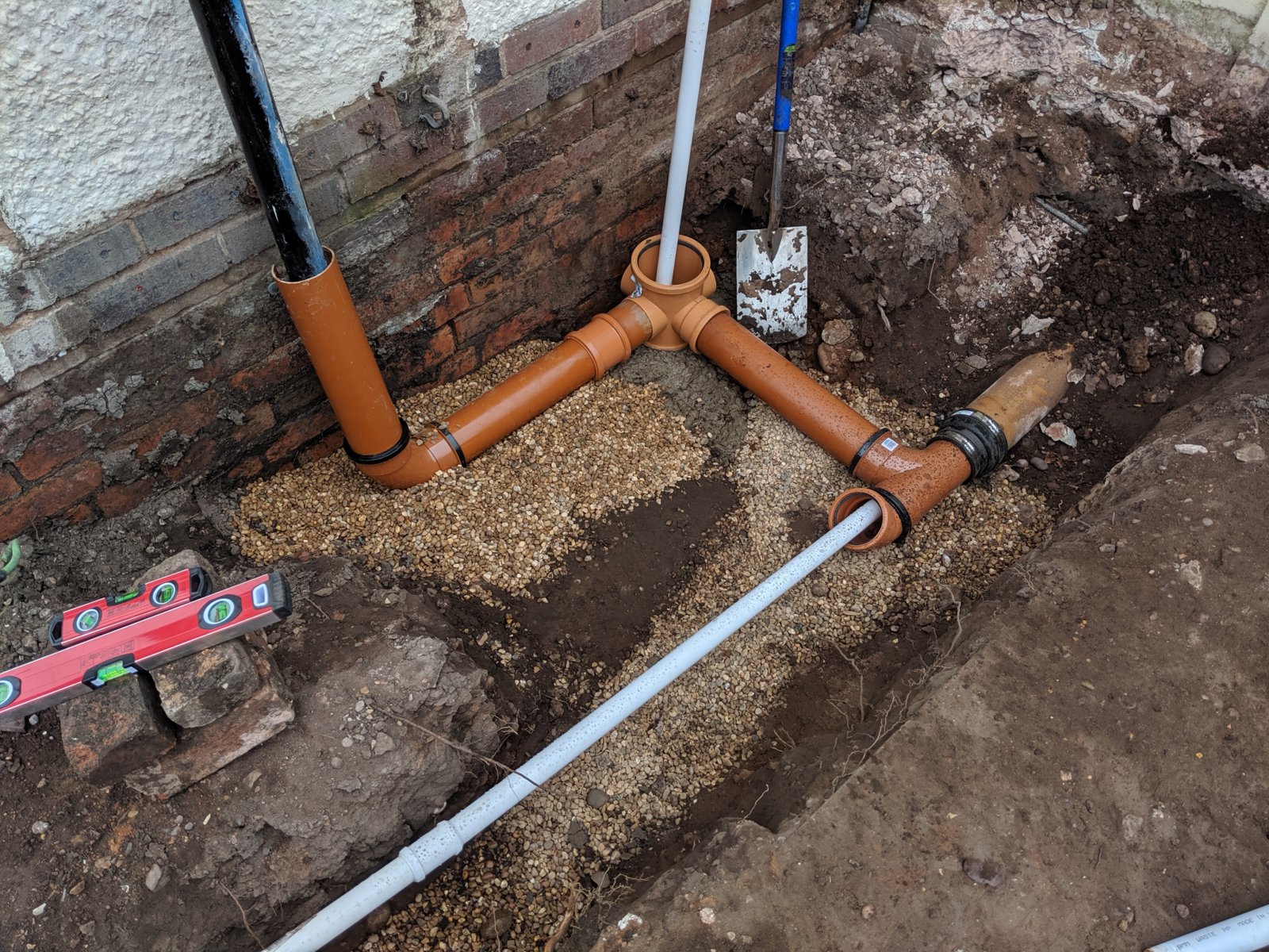

I decided to make a bit of a start on the underground drainage. For two reasons, really - one to get over my fear of cutting up clay pipe by "getting it over and done with" and two, to make it easier to ensure my drains can get through my foundations at the right height. And of course the best thing about DIYing your own project is you can just pick the bits you fancy doing on a given day!
Being an old 30's house, we had an old trap (That seemed to be leaky) connected to some clay pipe. I dug back hoping to find the soil pipe connection, but I imagine that's under the garage.
Anyway, not very exciting work - I used a 9" grinder to cut the clay (I did some practice cuts further up first!) which went through like butter. Then used a flexible clay -> 110mm coupling.
I then switched to my 4" grinder for cutting the plastic pipe and making a chamfer. To make the "backfill" in the new gully I had to buy a 110mm hole saw, and I used solvent weld to put in a short length of 110mm pipe. Hopefully, that works out!
Pics here: https://imgur.com/a/Ed5rhUF
(The downpipe 'connection' is, of course, temporary. At some point I need to drop a new piece of downpipe in and a nice rubber bung into the 110mm)

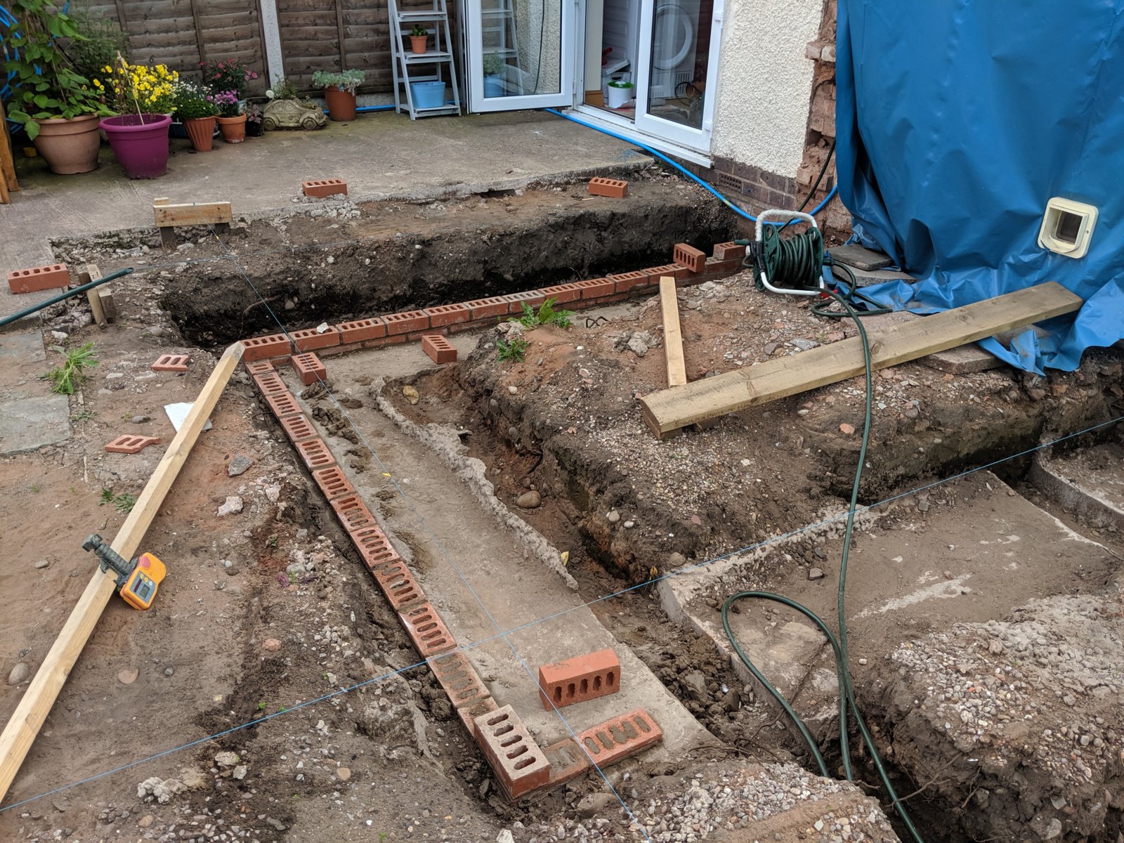

Will do a proper write up at some point, but just wanted to drop a progress pic for posterity!

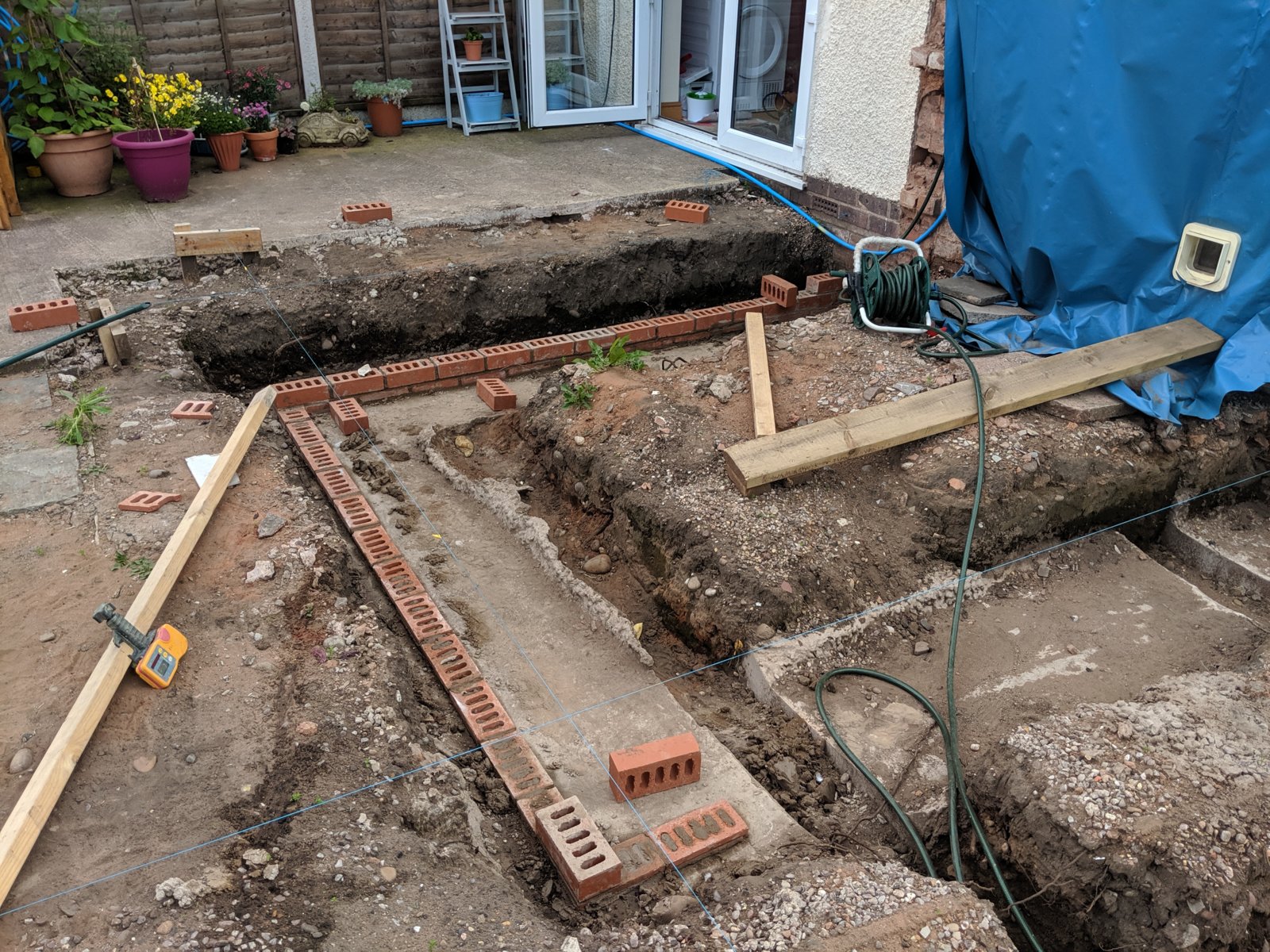

Incredibly slow going as you can see - unfortunately I've lost a huge amount of time to rain (And really the heatwave hasn't been great either!), work and other commitments and then just generally being a slow DIYer!
Still, there is progress and I think I'm actually enjoying it! All 4 corners (Well 2 corners, 2 nearly corners) at DPM height and perfectly level so I'm happy with that.

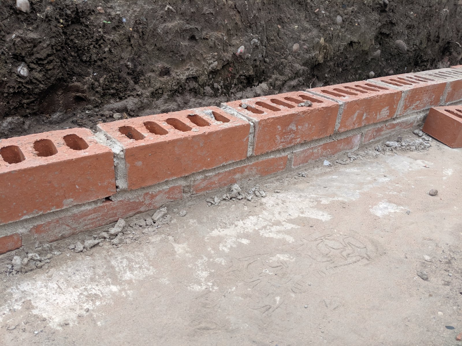

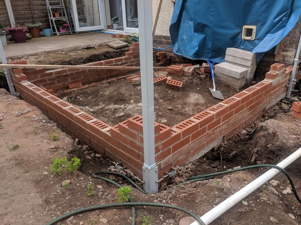

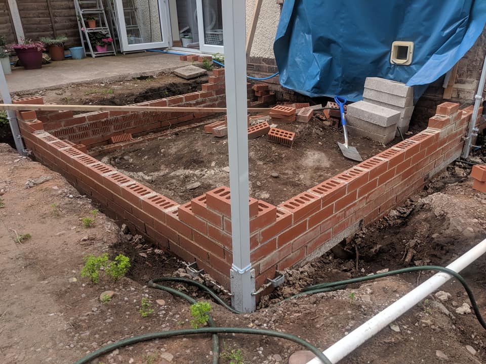

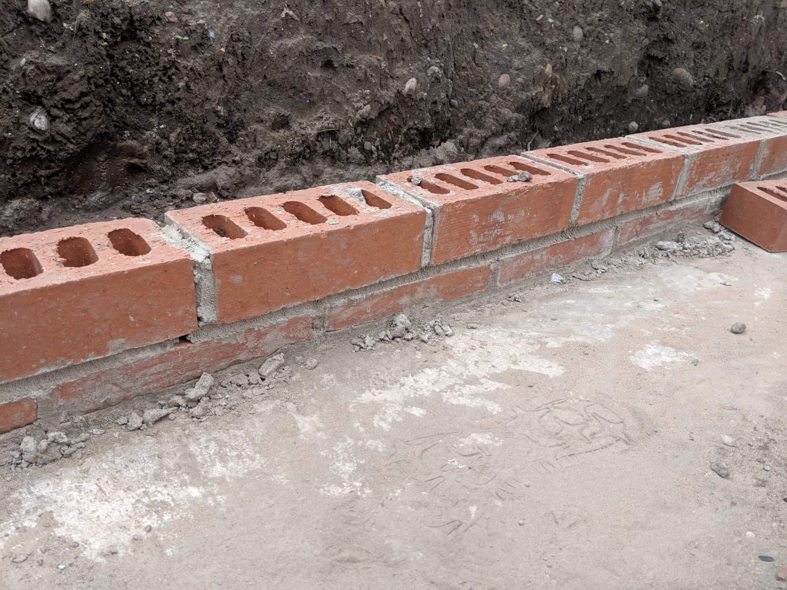

But jeez, where to start - that was hard. And I've got a whole new respect for brickies! Firstly, rightly or wrongly, to fix the issue with the concrete levels I decided to do a course of split bricks. I actually felt this worked out well, though it was pretty slow going to cut them all. I know there are other, and perhaps better options to sort that now but at the time I really wanted to crack on and picked a route I felt most comfortable with.
Just as an aside, I decided to buy an Evolution Disc Cutter for this project, as I found the 9" grinder just too unwieldy and, frankly, dangerous. Didn't really want to spend the cash, but I'm glad I did - it's been fantastic and gives you far more control over cutting.
Bear in mind my entire bricklaying experience prior to this was on a 4 day weekend course - the switch to working in real life and in a trench was a big one. Being honest, after the first couple of days I thought I'd made a serious mistake. I'd done all my setting out with string and wooden profiles and found it really hard to transfer that to the ground while accurately building and everything just seemed to take forever, and I often wasn't happy with the result. And then you're effectively working overhand while in the trench.
But all you can do is keep on pushing, and get better and better and at least nobody will see most of the underground bit. I did decide to pick up some Blakes profiles and I'm pretty glad I did - I know this defeats half the point, but it was great being able to use the string line to build up the corners.
The weather was an absolute killer as I'm sure you all know - seemed to either be heatwave or thunderstorms, with very little inbetween, and I also found dealing with the cement mixer to be a real faff. Though I did eventually learn that I can dig a hole to get rid of the water and such for cleaning the mixer!
Tips for other people reading - I found that if you're just planning on doing a small bit of work (e.g., build up a corner) then hand mixing in the barrow was easier than dealing with getting the mixer and everything out. And on that note, I found evenings to be great for that - just a single small mix but spend some time getting a corner or two up. Then it just leaves you running in on a weekend, which also felt great.

The awkwardness of laying bricks in a trench is why it is srd practic these days to mass fill trenches, then do just 1 block course and a few brick courses to get up to damp.

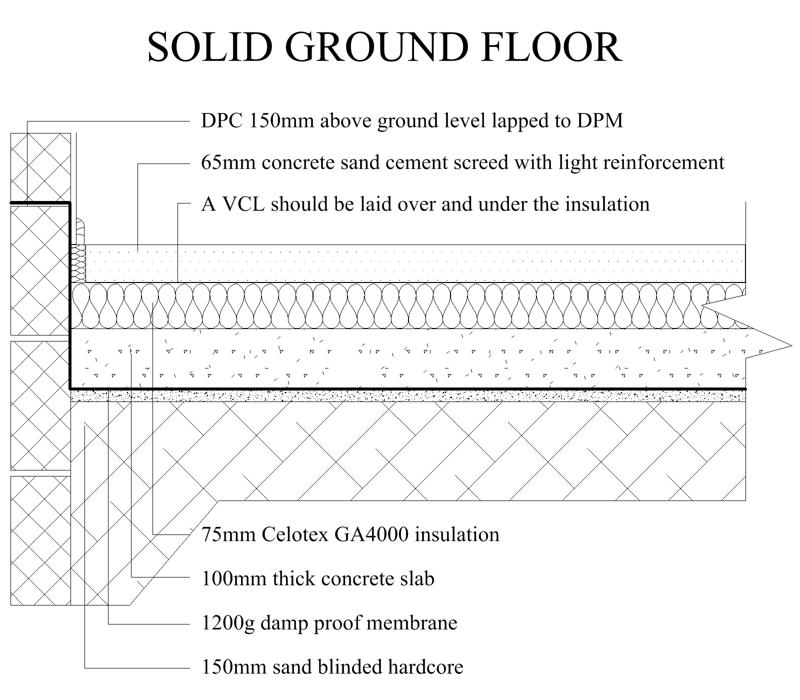

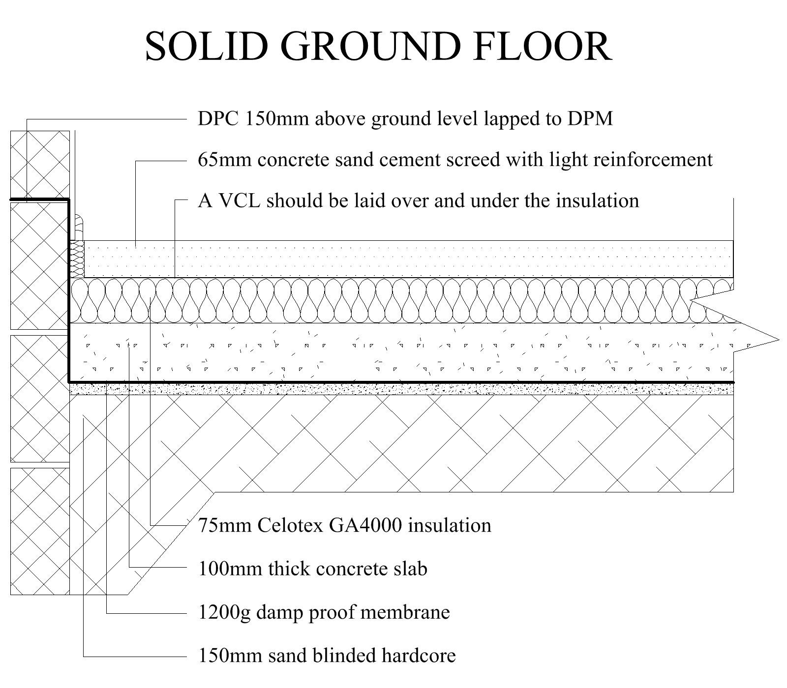

Hmm, you're worrying me now! The brickwork is at floor level / DPM level now and I was going to work backwards from there to work out where my hardcore needed to finish and follow something like the attached. Have I gone wrong?

Yes, all youve got to do is remove the brickwork from the inner skin where the door opening is.
It needs to be removed down to top of oversite.Then when you do the floor, the insulation will run across the door reveal and hit the back of the outer skin.
The screed and insulation needs dpm between it and the wall.
Either put in a few straps or some slates or similar to support the insulation across the gap.
