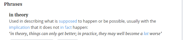

“Theoretically yes” has the definition that something is possible according to theory. As I have said before I think you are saying “will this happen in real life?” and as I have said before, it is unlikely, perhaps very unlikely but as you concede it is possible, in theory, for what I describe to occur.
To be clear I am not saying that it is necessary to fit smaller fuses, I am sorry if I gave that impression. I am simply giving clear, valid technical reasoning as to why fitting a smaller plug fuse may provide additional protection in certain circumstances. Assuming that standards are met, I agree that just because a small amount of additional protection may be available, it doesn’t mean that you have to do it – just look at some Chinese products, they take this to the extreme!
I’m not saying your statement is wrong, but you have made a statement with no justification and give no principle behind your argument. You need to explain, with valid technical reasoning the basis behind your view, rather than saying “could it…” to my reasoning and then stating something.
I think we have reached a consensus of understanding, but just in case you feel I haven’t fully answered your questions, you ask for an example twice, but I have already provided two examples in my previous posts which describe how the situation that I am explaining could occur; the heater and the motor. However you have already agreed that is theoretically possible, so I don’t think further explanation is needed.
Finally, yes I was asking you to guarantee that fitting a smaller fuse could never be beneficial. In a similar way that manufacturers guarantee (and are liable for) their products not breaking down or catching fire. Sometimes, despite all the design, testing and protection, faults and fires do occur and hence they have to pay out… I see you are not willing to put your money where your mouth is! Probably as you agree that what I describe could theoretically happen, which is a wise move!
Are you confusing theory and hypothesis?
http://www.oxforddictionaries.com/definition/english/theory
If you think I have confused those two words, you have clearly misunderstood everything I and others have said.
Your own linked Oxford definition is appropriate here theory - "A supposition or a system of ideas intended to explain something, especially one based on general principles independent of the thing to be explained:"
If you agree that the theory of what I describe (with technical and scientific basis) is correct, I think we are on the same page. If you are saying that fitting an appropriate but lower than 13A fuse can never provide any additional protection to an appliance under any circumstances, then please do explain, with technical and scientific reasoning, why that is the case.
