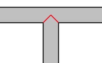

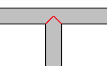

And if your installation isn't to look crap, you need to keep this small gap consistent along the run.
IME, as long as you get the angles right, and you are neat and precise with your cutting, a mitred corner looks much neater than an oversized L piece.
Ditto butt-joint Ts vs oversized T pieces.
More work though, as is often the way. cf plumbing done in copper pipe vs plastic push-fit.
