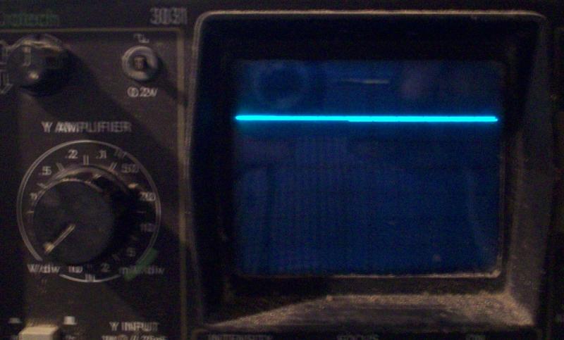

That may be true of some LED drivers, but I have to say that I routinely use cheap "12V DC Led Drivers" for mains-driven control of standard 12V plug-in relays (120Ω, 100mA, 1.2W), without any trouble, and the DC output of the 'driver' is remarkably clean (this is an Aurora 12V 0.8A constant-voltage LED driver, loaded by 1 relay such as I described). Apologies for grotty photo, but I think it illustrates the point!:
I'm sure that would happily power a small 12V DC fan.

If you did have a driver (such as bernard described) with a 'messy' output, then you might well not even need an electrolytic capacitor - if it' a SMPSU, the frequency could well be high enough for a modest size (non-electrolytic) capacitor to be adequate. Having said that, if the one I recently illustrated is anything to go by, the manufacturers have probably already thought of that, and already include an adequate capacitor (and/or other regulation circuitry) in the driver to produce a pretty clean DC output.
