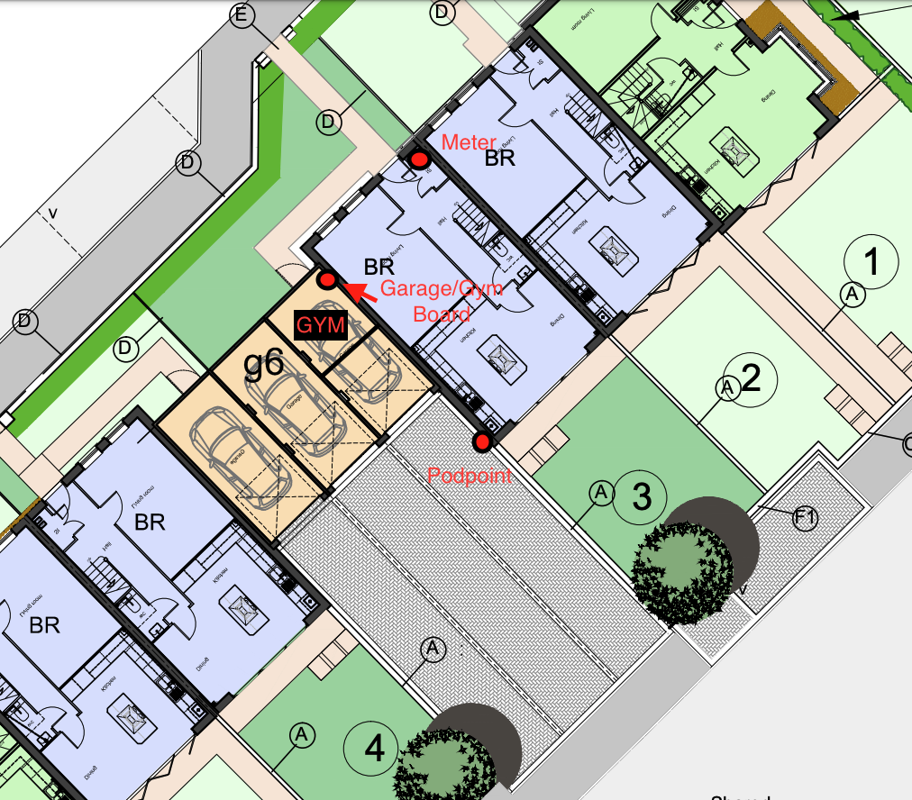

This is where I was surprised with the process.
Before even visiting the site to inspect the installation they "require" me to provide photographs and written evidence of all CUs, MCB part numbers and manufacturers, required cable route, photographic evidence of earth bonding and meter details. If I cannot provide the required evidence that I should "employ an electrical contractor" to verify and gather evidence or the installation may not go ahead/be delayed.
I said if I gather all that myself you may aswell just mail the charger and I'll install it myself lol
I'm not a sparky but understand all the things they are asking for fortunately but I cant help but feel other folk like my missus who's a nurse wouldnt have a clue about any of it.
I deliberately left the desired cable route question blank and wrote "require advice from podpoint" to illustrate the point you make. I dont want to tell a sparky how to run cables
'Craftsmen' as Eric put it, are getting fewer and fewer - and so there is a danger they will do it the easiest way, and even if you did suggest a neater yet harder way, chances are they will say 'no', 'not allowed', 'too much effort', 'can't be done', 'no time for all that' etc, etc, etc.
Today's craftsmen love sticking self adhesive trunking all over the place.
I seem to recall Eric specified how he wanted his mother's place done, only for them to do exactly what he didn't want done.
No harm in specifying or making suggestions - it's your house, and you have to live with it.
You could of course get a draw wire put in first over the hall ceiling, to save them time, and to save any time wasting on the day.
Removing the kitchen plinths and anything in the way will also help the electrician, and encourage him to do it your suggested way.
Yea I'll happily discuss the requirements with the guy when he comes.
As you say though, I just hope hes of the few craftsman left who take pride in their work.

Lol at the thought of EV installers being "Craftsmen"!
Now the smart meter rollout has hit peak, many companies are now re-training meter installers to do EV charger installation as the next big thing.
So if you're going with an installer from Mitie, Lowrie Beck etc (who Pod Point, Zappi etc all subcontract to) then you're probably getting someone who did a six week meter swapping training course and then a week long EV installation course. Not exactly time served!
It should all be safe of course, that's why they want photos of consumer unit etc for a sparky to check at base in advance, and why they are using chargers with type A RCD and PEN breakage detection for all installs . But many of these installers are contracted for two installs a day and have never used a set of cable rods before. You have to set your expectations accordingly.
What are they then, if your going to employ an electrical contractor why would you need some one else to come along and fit the EV charge point, the electrical contractor would do that.

This was my thoughts also, it seems absurd to employ an electrician to ensure the other can do his job.
