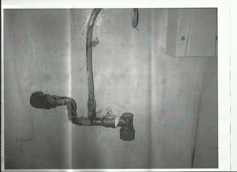

We have bought a memory stick to get a copy of the video after the weekend. The photos of the pipe and fittings provided are of very bad quality (I'm attaching them anyway) - is it worth seeing if colour vfersions of these can also be loaded onto the memory stick?
well in my view even hitting the pipe taking out your cooker wouldn't have caused that leak unless the elbow wasn't soldered correctly or was corroded, i can't see any protection on the elbow in the wall, i bet the ptfe tape on the baynot fitting isn't gas approved either, nice big dent in the pipe in pic 3 as well, the thing that makes me really suspicious is the pics & video, i don't know any RGI or BG that are called to a gas leak & then takes pics & video of before & after why did they do that unless they were trying to pull the wool over someones eyes
