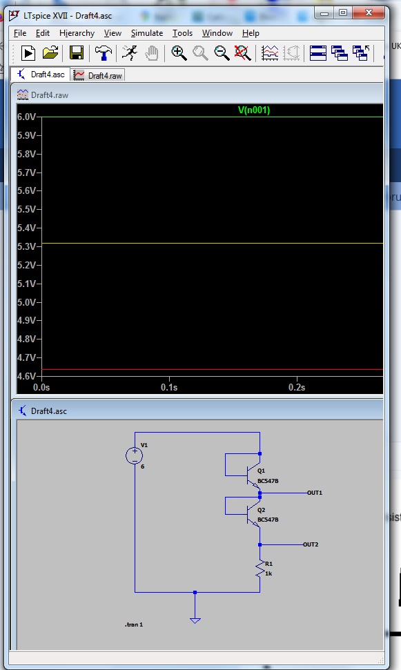

I suggest you go away and build yourself an experimental circuit or try LTspice.
So would my second circuit work ok?

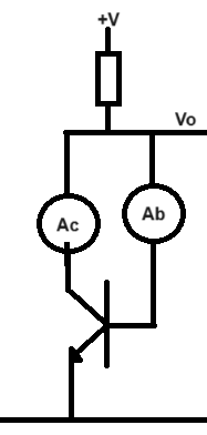

Try this simple circuit with 2 ammeters:
I predict Ic will be very low, Ib will be a whole magnitude bigger, Vo will be some random voltage under 0.7V dependant on Hfe

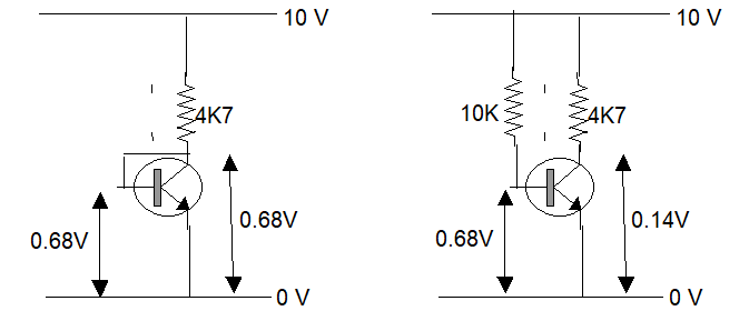

No I've just tried it with a single 2n3704 and 1kΩ resistor. Using a variable power supply of 1-10V the voltage across the transistor varied between 0.3 and 0.5
OK. I've done my "thinking harder" as a result of which I think I essentially agree with what you all have been saying. It seems that I had been had been overlooking the fact that to achieve saturation, Vbe must be greater than (not just equal to) Vce. I have also think that I have more-or-less satisfied myself by trying with a random NPN transistor and a couple of near-to-hand resistors....
... with B and C joined, Vce (and,obviously Vce) was 0.68 V,around the expected BE junction 'threshold'. However, if I biased the base, then Vce fell to 0.14 V [(i.e. "Vce(sat)"].
Having said that, I still think that my original suggestion (to ignore the collector and just use the BE junction) would probably be an acceptable approach, given that Ib(max) is usually much the same as Ic(max) for small transistors.
