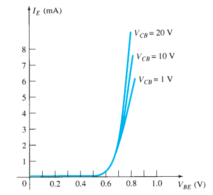

Thanks, but I still don't really understand your point. Are you perhaps assuming that the voltage would be exactly 0.6V at a current 'slightly over 0 mA (and,if so, why?) ? The graph only goes down to 10 mA, but the way the curves is heading suggests that it would hit 0.6 V at a current of about 7 mA- not all that much closer to 0 mA than is 10 mA.
One conceptual difference between the curves for diodes and transistor BE junctions is that one is 'concave' and the other 'convex'. I haven';t yet found a BE one which goes up to reasonably high currents but ones like this one illustrates my point, since it shows that Vbe changes little for increases in Ib beyond a very small number of mA...

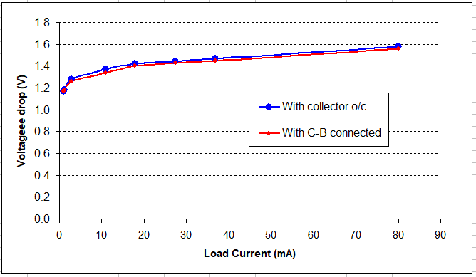

As I said, I couldn't disagree with your statement, but I also don't think it really makes any significant difference whether or not one connects the collector,given only that the transistor can stand the current concerned through its BE junction.
To reassure myself about that view, I've just experimented with the BE junctions of a couple of BC107s in series, with a 6V supply, with and without the collector connected to the base - and, as you can see, there is virtually no difference between the two in relation to the 'voltage drop'.

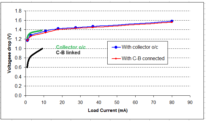

It's so different to
I've just tried it with a single 2n3704 and 1kΩ resistor. Using a variable power supply of 1-10V the voltage across the transistor varied between 0.3 and 0.5
Where the current was essentially upto 10mA I didn't note actual readings to plot an accurate graph but I think my additions are approx representative of my very quick test except I've predicted what would have happened with 2 transistors from my test with one.

It's so different to .... Where the current was essentially upto 10mA I didn't note actual readings to plot an accurate graph but I think my additions are approx representative of my very quick test except I've predicted what would have happened with 2 transistors from my test with one.
Indeed- very (and inexplicably) different.
If I understand correctly, you have done something slightly different from me, in as much as it sounds as if you varied the 'supply voltage',whereas I had a fixed (6V) supply and varied the resistor to emulate changes in thee load - but I can't see how that could explain what you observed. In particular,I can't really see how, with C and B connected, thee 'voltage across the transistor' (C-E and B-E) could bee as low as 0.3-0.5 V,and nor can I see how connecting C and B could result in the large change in that voltage which you report!

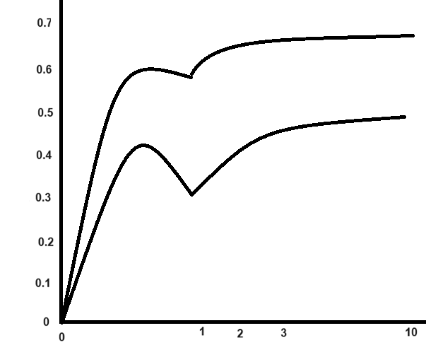

Yes I did it differently but the effect is the same, ie pass a current through a device. to me the green curve emulates your findings perfectly. As mentioned I didn't not any stage reading, literally varied the voltage between 0-10V several times and mentally noted max and min voltage with collector isolated, then connected. Below 1V it seemed to follow the supply V so there was an early hump, very vaguely this idea but in no way to scale:
Hence the reason I only mentioned 1-10V earlier. If I get the chance I'll have another play later.

...once I started 'thinking straight' (remembering the conditions required for saturation), I realised that one cannot achieve C-E saturation if C and B are joined - since one of thee requisites for that saturation is that Vbe > Vce (which, in practice, occurs when Vce falls to below Vbe).
