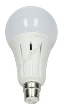

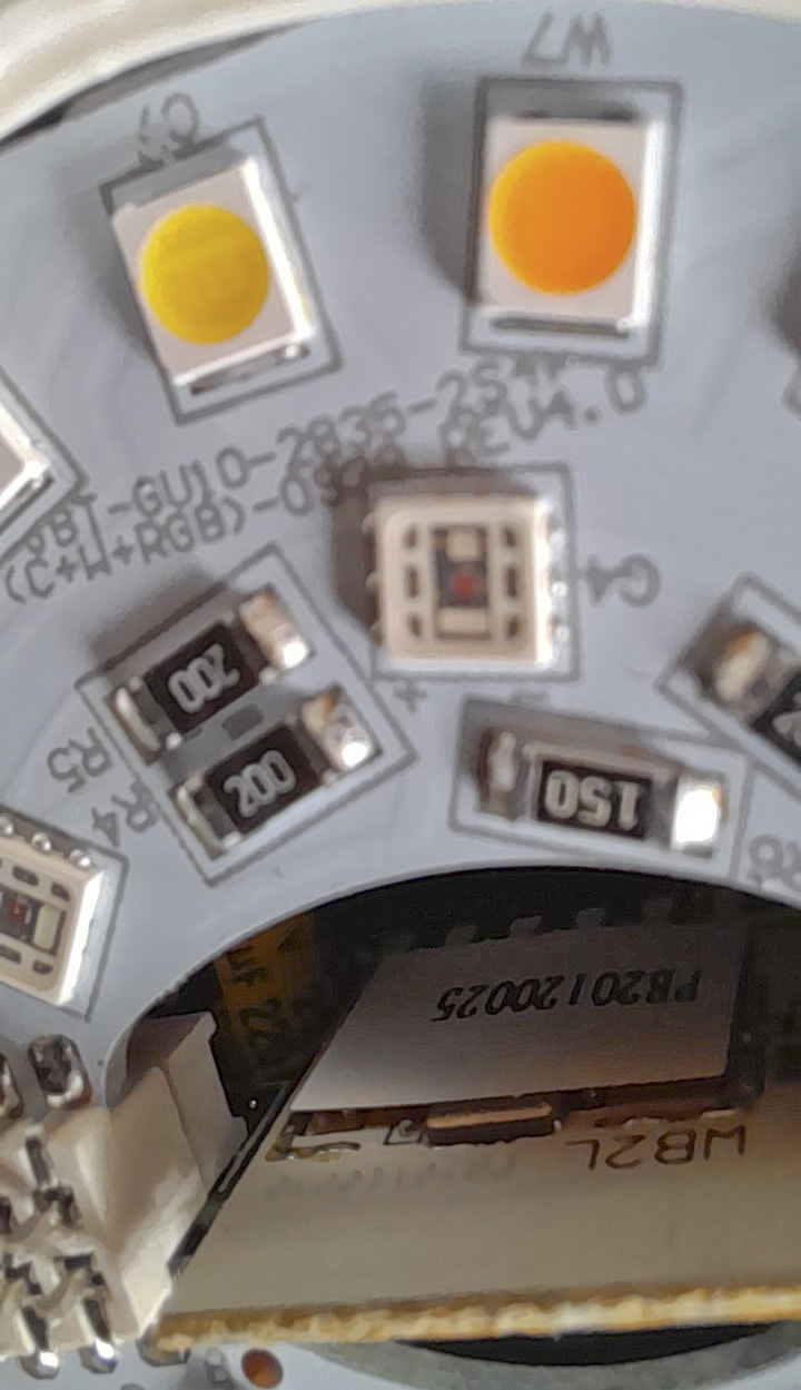

The light emitting part of the lamp 20220603_113543_1.jpg tends to be mounted on a printed circuit also designed to remove heat, putting a globe in front of the chips be it candle or bulb shaped, will to some extent defuse the light, but still most goes forward in the direction the chip is pointing.

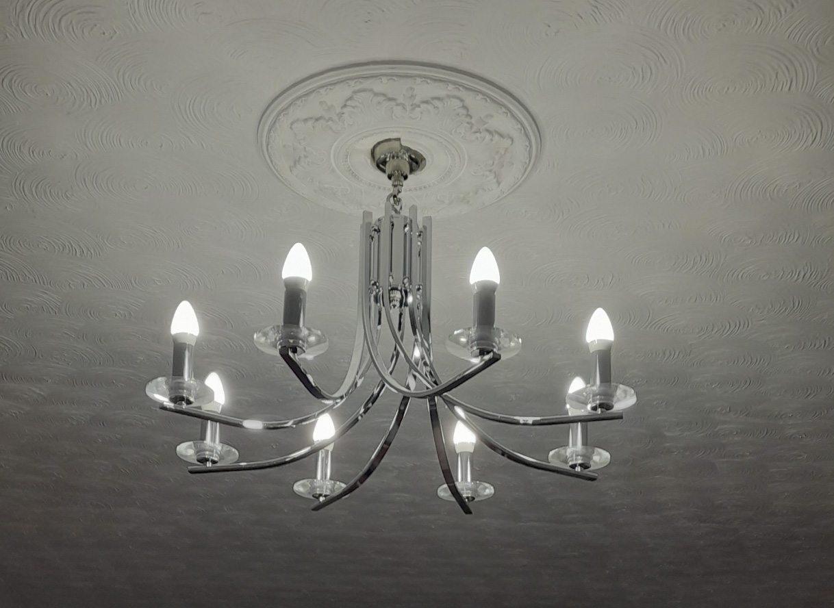

So 8 bulbs like this, 20220415_000328_1.jpg shine up to white ceiling and are reflected from the ceiling giving a reasonable shadow free spread, but reverse it as with this lamp-landing_1.jpgexample and to get the spread the fitting needs to be high, this one over the stairs, the dangling bits do defuse the light a little, but not really enough, however it was got to look nice, more than to get the light required.
The first chandelier was fitted to replace a single 100 watt tungsten bulb, so 8 x 6 watt is 48 watt, so halved the power used, and it give a better spread of light. However no single LED bulb really would without changing the fitting replace the tungsten, this one 1705323754472.png rated at 24 watt, 2452 lumen is going to emit far more light to a 100 watt tungsten, but one £12.49 and two the wrong direction, we can google it for you but sure you could do the same without the link.

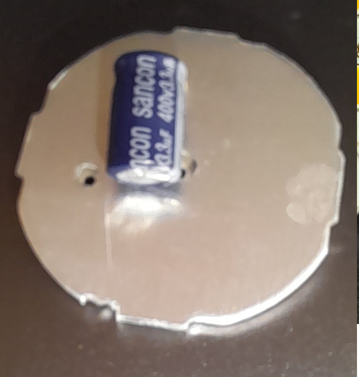

Inside of a failed candle LED bulb, 1705399671068.png1705399535367.png one it shows although a candle bulb, all LED's face away from base, but also second picture shows the reasonably large smoothing capacitor which should stop the strobe effect.
I have seen the strobe effect, but would assume that is a faulty bulb.
