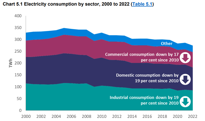

Yes. Electricity consumption down almost every year and in every sector.
There are efficiency improvements in most areas but lighting is by far the most dramatic.
source: https://assets.publishing.service.gov.uk/media/64f1fcba9ee0f2000db7bdd8/DUKES_2023_Chapters_1-7.pdf
I only briefly scanned the PDF, but it doesn't say that the shift to LED lighting has been the main driver in consumption dropping.
Other articles suggest that lighting in domestic properties (globally) only accounts for 4% of domestic consumption. If we assume that LEDs use 75% less electricity, 75% of 4% is only 3%- would that explain the drop of 19% in domestic usage since 2010?
According to an estimation by the International Energy Agency (2016), the residential sector accounted for 21% of the final energy consumption worldwide in 2013. Although there are considerable variations in energy usage across countries, on average, households use 52% of energy for space heating. Compared to the share for space heating, the share of energy consumption for lighting is relatively small and accounts for only 4%.
Granted, some countries/continents will have different lighting requirements, but might it not be the case that improvements in heating systems and insulation have had a bigger impact than lighting?

It's very difficult to attribute any single cause to the drop in consumption, unsurprising as there isn't a single cause. But it's obvious that any household switching from filament bulbs to LEDs will definitely save a substantial amount per year, probably covering the cost well within a year.
The wasted energy does heat the room, but this heat is still 3x more expensive than the heat from gas heating or an electric heat pump. Also it's only welcome heat when it's cold, it's a disadvantage in the summer - especially if you have air conditioning, in which case you're paying again to get rid of it.
Not in the UK - most properties are heated with gas or oil, so electricity use is unrelated.
Insulation improvements have been stalled for the last 10 years because a previous PM decided to 'cut the green crap'
Probably true in some places at some times.
Massively depends on the property - if it's a single pendant in each room, lighting use will be small.
However with the massive overuse of downlights in every room, electricity use would be vastly higher as a percentage, such as kitchens with 20x 50W halogen lamps in.
Commercial/industrial installations will be a much higher percentage as lights are typically on for extended periods including permanently, and there are a lot more of them.
They are not all fluorescent to LED conversions either - plenty of retail and hospitality venues used vast amounts of incandescent and halogen lighting until only a few years ago.
