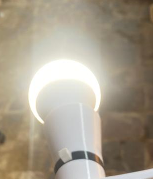

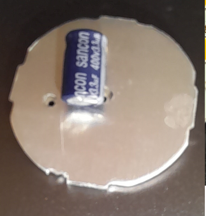

Inside of a failed candle LED bulb, View attachment 329358View attachment 329357 one it shows although a candle bulb, all LED's face away from base, but also second picture shows the reasonably large smoothing capacitor which should stop the strobe effect.
I have seen the strobe effect, but would assume that is a faulty bulb.
By strobe effect, I mean, by way of an example, waving your hand under an LED bulb and watching it look jerky. I don't mean a bulb that is noticeably flashing on and off.

As I recently said and illustrated, despite the way in which the LED elements are mounted,a substantial amount of light comes out of the lamp/bulb 'in all directions', particularly in the case of 'GLS-shaped' LEDs (probably less with candle bulbs).
One of the reasons is that, although mounted on a plat plane, the LED elements do not have a very narrow 'beam angle' -I imagine that it is not all that much less than 180°. Added to that is the 'bouncing around'(reflection) of light within the translucent envelope.
With a 'GLS-shaped' LED, even if one looks from 'behind the base', there is still a very appreciable light output ...
Of course, if there is a 'reflector shade' (as with some table lamps,w alll ights and downlights etc.), then the fact that the light all goes 'away from the base' is presumably a definite advantage?

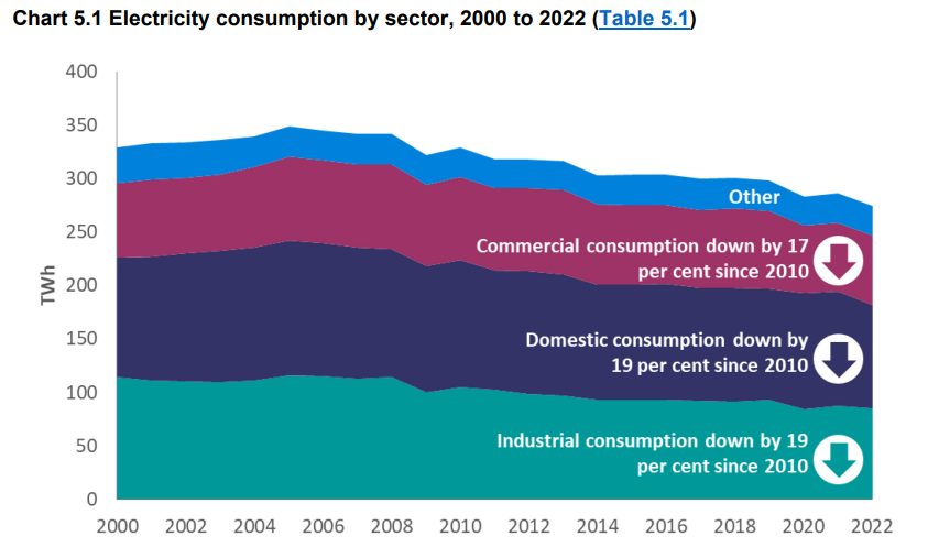

Yes. Electricity consumption down almost every year and in every sector.
There are efficiency improvements in most areas but lighting is by far the most dramatic.
source: https://assets.publishing.service.gov.uk/media/64f1fcba9ee0f2000db7bdd8/DUKES_2023_Chapters_1-7.pdf
Fair enough, even though the falls appear to have been relatively modest (and presumably due to a combination of factors).
Without some data, I cannot argue, but I remain very surprised, particularly in the most recent years, since I would have thought that the increase in EV charging alone would have more than compensated for reductions in energy used for lighting. It seems that, in the absence of knowing any 'numbers', my intuition may be wrong!
... but one needs to remember that, particularly in the most recent times,"efficiency improvements" is by no means the only reason for reductions in energy usage. In those 'most recent times' a fair bit of the explanation for reductions in energy usage (in all sectors) has presumably been due to the fact that that many people/companies have simply not been able to afford to do otherwise.
