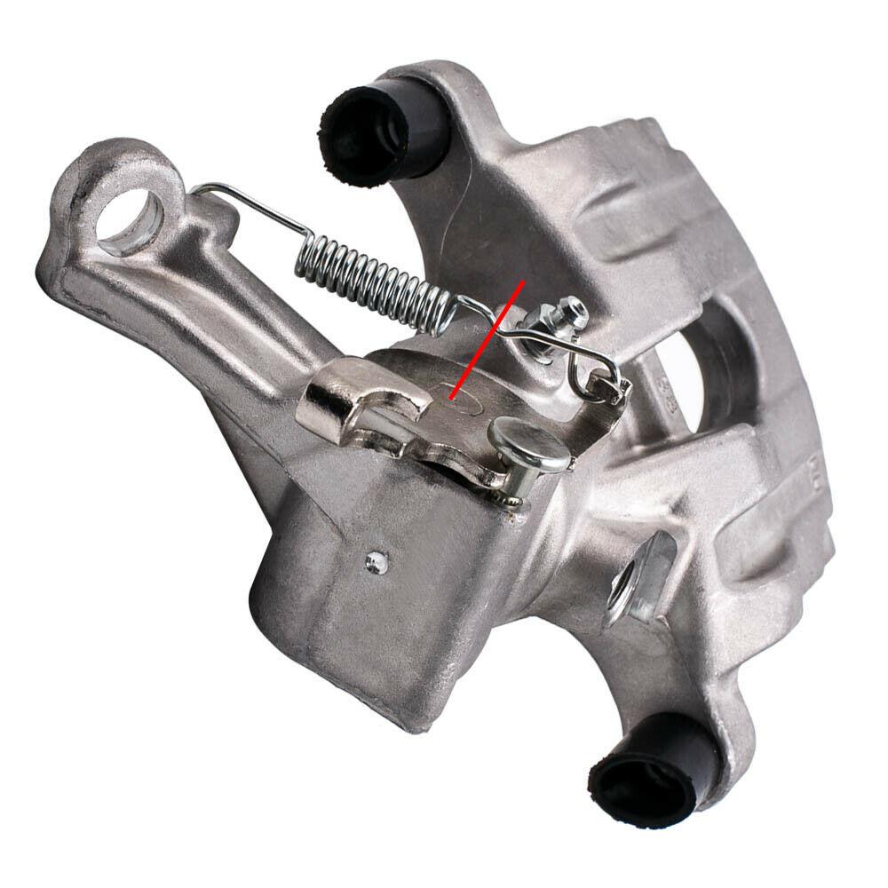

Car handbrake cable loose where it attaches to the brake caliper and not holding the car. video inc

That handbrake operating arm in the caliper is seized up. It should operate a cam inside the caliper and easily spring back to the off position when the handbrake is released.
Unhook one side of the handbrake at the wheel and neither side will work, because there is a balance or equaliser lever at some location in the vehicle. That balance the braking force of the handbrake between the two sides of the car.
The dribble of diesel might fix it temporary, but longer term it needs a new caliper - it should not be taken on the road until it is repaired.
hi , thanks for that info. I need this sorted asap as the mot for it is due in 8 weeks
I changed the calipers discs and pads almost a year ago, all was fine it passed the mot no problem. I tried later to make handbrake tighter and undid the cable though I don't know why I did. Anyway after connecting the handbrake cable again the wheel locks up it drives fine but the brakes quickly overheat so I left cable disconnected for now.
The handbrake operating arm/spindle was seized but I got it working again and it now springs back and forth.

Okeydokey, back to basics. if the calipers have been replaced recently (with recon items, NOT from a breakers yard) they should be just fine and need no attention just yet.
With the cable disconnected, you should be able to move the operating lever by hand, but only a short distance. The lever should then spring back to its stop. if it does this, all is well.
As before, I think a new handbrake cable is what you need.....one cable feeds both wheels, if I remember - that's common practice these days.

It seems the Vauxhall rear caliper differs to the VW type. On the Vauxhall, the lever appears to be press on to spindle rod for the handbrake. I can understand how its gotten rusty if water's got in.

are the handbrake mechanisms now rotating freely and returning to their stop positions?
