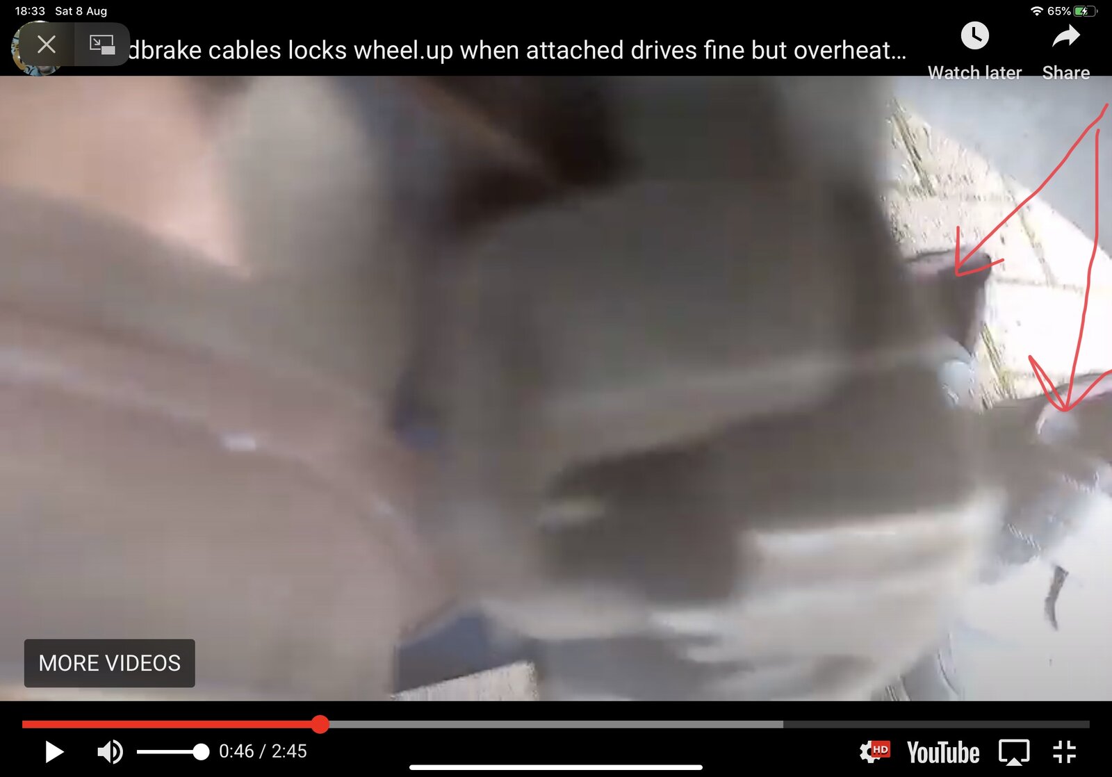

Car handbrake cable loose where it attaches to the brake caliper and not holding the car. video inc

We’ve seen the handbrake lever moving, we’ve seen the cable moving. You need to fit the return spring back on and show us what is happening when someone else is inside pulling the handbrake lever up and down. Can you film that?

Because the lever was siezed but now you released it the spring has a job to do.
And you cannot adjust the cable it is a set length there is a reset under the console not adjuster.
