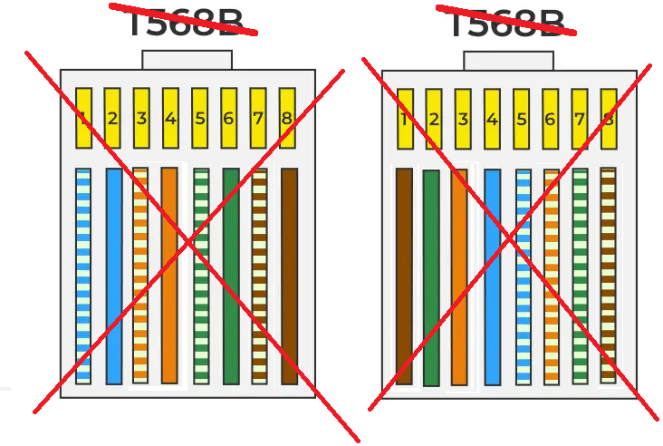

You said you followed the T568B wiring to a tee, but just wanted to make sure which way round the plug was- you should have the gold contacts facing you.. upload a clear picture of your plug so we can see the wire colours through the plastic?Ah

One has to remember this format has developed over the years, I'll take a punt that it is/was simply T568. The A and B suffix relating to the A end and the B end of the path between between 2 devices, don't forget that in earlier formats all systems required a crossover somewhere.
In my minds eye 568A does seem more logical than 568B but there again I feel both of these are even more logical
deliberately croosed through so no-one thinks they are advice.
However I wouldn't split pairs across a connector (as done with pins 3&6 in 568 or my right image) as the whole point of twisted pairs is isolation.
