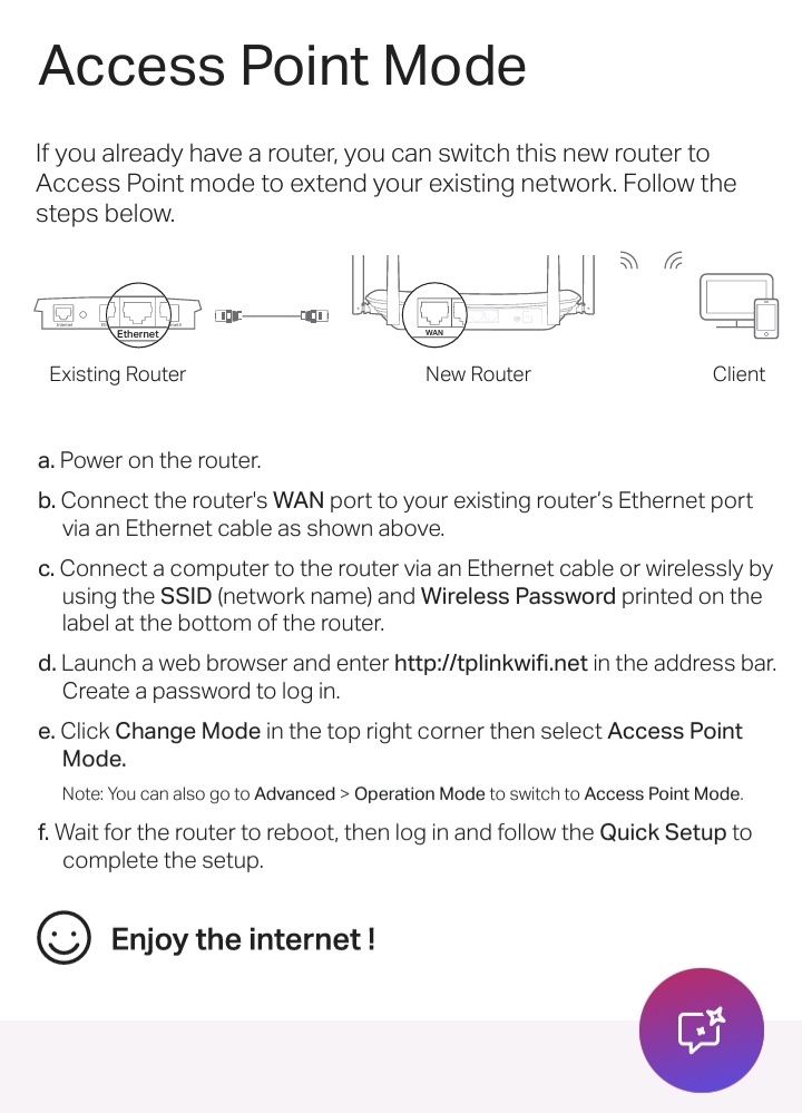

What ive done so far...and still need help please...maybe I've bought the wrong thing I don't know...
Cat5 all connected and tested.
Bought a TP Link Archer C50.
Connected it to the Ethernet cable that goes into the main router and went into the Quick Set Up Menu.
I've set it up as an Access Point as that seemed logical, on both bands 2.4 and 5 ghz. Everything thereof completely bamboozled my brain.
Cat5 is connected to Lan Port 1 on the house router and into a Lan Port on the TP link "probably no.1" I have WiFi but no internet, I've gone back into settings for further bamboozlement, followed you tube videos and still no internet in the summer house/Shed.
Would you mind guiding me again please?

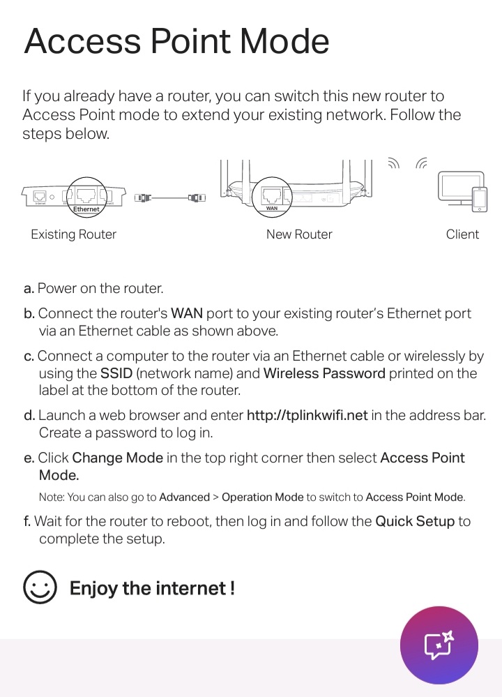

...and looking up the C50 (is it the AC1200?) - it's a router rather than an access point - hence the added complexity...
Did you follow the instructions to set up access point mode?...

I used the shorter cable in the house and the Internet on it worked.
Plugged it in in the GR in the WAN port other end in Lan Port in house, I just get an orange light and that's it.
Yes I connected the C50 to my laptop to change the settings to Access Point etc.
I can get a Cat6 cable run if the cable is the issue, do you think?
If it worked in the house, but not in the GR, then as above, I would suspect bad/mismade connections.
Can you post a decent pic of the connections, and we may be able to double check the wires are in the correct places?

Shouldn't this be the WAN or Internet port?

As above, access point mode needs minimal configuration - and you've already said it worked when connected directly to the router.
There would be no need for any changes to the config, if it worked in the house.
