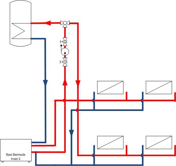

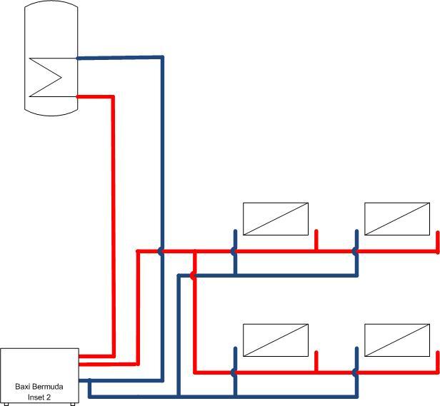

The above tests are helpful but we need to know the layout of the pipework. Without knowing how many pipes are connected, we can only guess what is happening.
So, we need to identify what is connected to the boiler. Please see my last post regarding tests before reconnecting the pump. In particular, we need to know how many flow pipes are connected as the boiler has the possibility of two physical connections for flow and one for return (however it can be installed as one of each).
If there are two flow pipes, I am thinking originally it looked something like this: (prior to the pump and 3pv being installed)
EDIT: As per DIA's post below & MI
Two flows + two returns UpgradeME.
The heating return is an injector tee for a pumped return.
It's going to need an RGI to remove the fire front and physically check the connections, and take a pic or two for us.
Going to do another sketch, to see what it looks like, and the possibilities.
No, originally both returns would have connected to the boiler with the pumped return as shown in the earlier in the MI pic.

Done sketch and the above tests doesn't add up.
If you close the heating port, you get a reverse circulation through the cylinder, Whereas in the mid position, the flow is technically correct.

You have told us what get's hot at the cylinder/pump. We need to know if there are one or two flow pipes coming from the boiler (possibly the top two). The tests I mentioned on Pg16 are at the boiler side, rather than near the cylinder/pump.
UpgradeME.
The original drawing the flow and return at the cylinder are reversed, the gravity flow would be the top pipe.
Otherwise it would be much as it was except the pump would have been on the heating return.
The second drawing is unlikely as the heating is split into two circuits, one without a pump flow, and we know all the rads work in the mid position.
I'm still at a loss as to why shutting port A reverses the gravity flow, or perhaps we are led to believe it does, and shutting port B leads to a surge through the coil. Clearly there's a conflict with the 3port valve.
