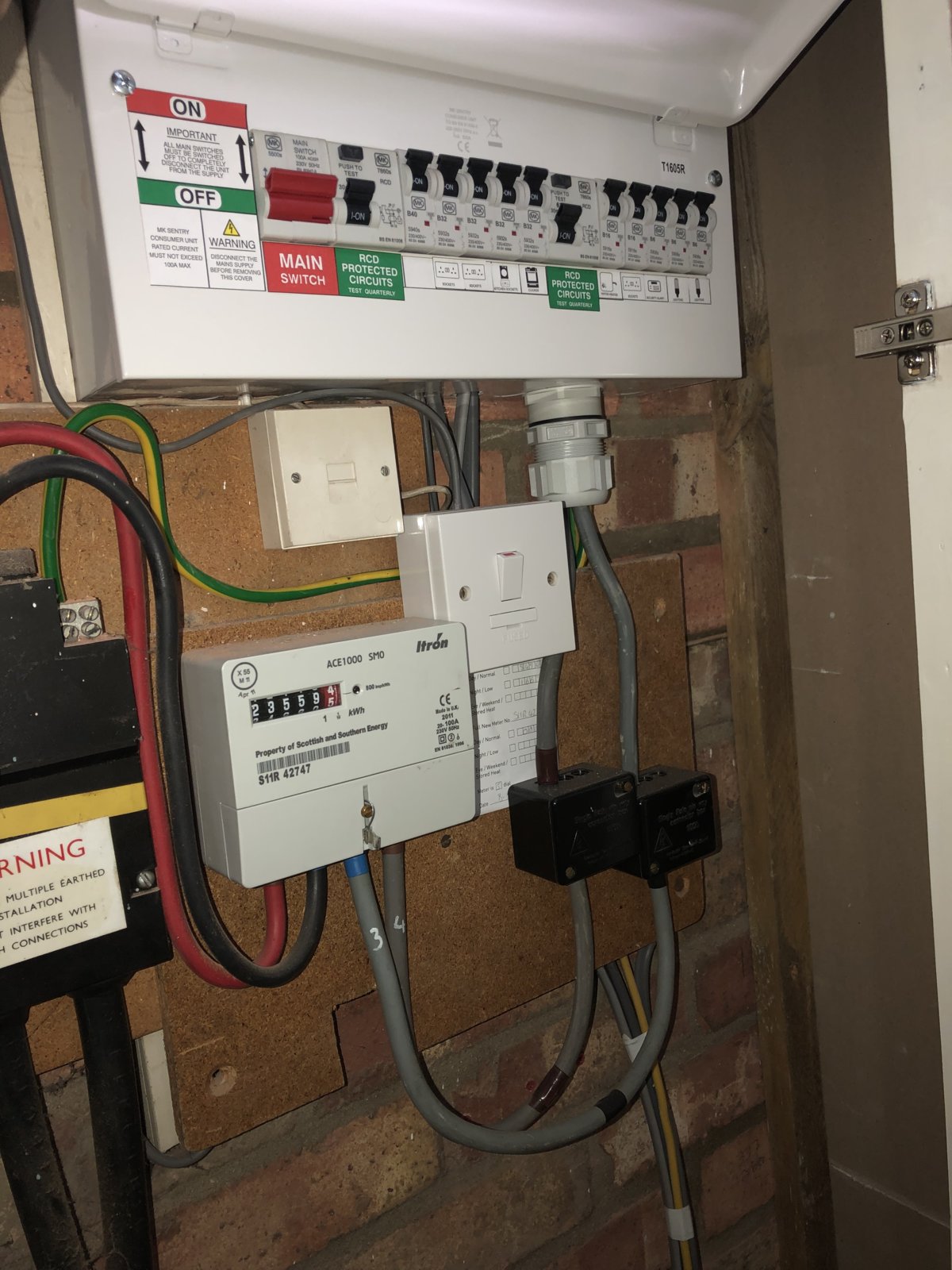

Change of electrics required for new oven?
Tbh I’m no electrician obviously
This is just what a couple of napit guys have both said
Change the 32 to a 16.
Does Anybody know where I can get a 16 amp breaker for my consumer unit please?
Pic attached
I’m going to supply to a friend who can do the whole thing for me :)
- change 32 to 16
- connect single oven up to existing fcu
- spur off socket to provide socket for microwave

Haven't read the whole thread but I'm a fully qualified electrician. What is the wattage of your new oven? The microwave on a 2.5 is no problem. It will be on a 13amp plug top. Ideally it's two 2.5 radial circuits so it should be on a 20A MCB maximum. Most cooker circuits are wired in 6mm

The oven I bought is 3.2kw
https://www.currys.co.uk/gbuk/house...-steam-oven-stainless-steel-10166671-pdt.html
I’ve had the old gas oven disconnected .
Will have single one connection to existing fcu. That’s on a 2.5mm radial and change breaker from 32 to 16
I will then spur off the kitchen socket ring (-also on 2.5mm) and make a plug for the portable microwave :)
3.2kw is 14A so your about right on a 2.5. That seems low power for an oven tho to be honest. The microwave will only be pulling about 5A. I'd stick it on a 20A MCB and see how you get on. The cable will be covered and from those wattages it shouldnt overload
And yes I forgot to mention sorry - that from consumer unit - there’s a 4 or 6mm cable for about 1 metre that then splits off into
the 2.5 kitchen ring cable
The 2.5 radial oven
Why it’s like this I don’t know. The napit guys I had round said the person who converted the garage was probably not a sparky but “knew” some electrical stuff and was able to keep it going
Based on this - would you still say 20 or 16 mcb to replace the 32??
