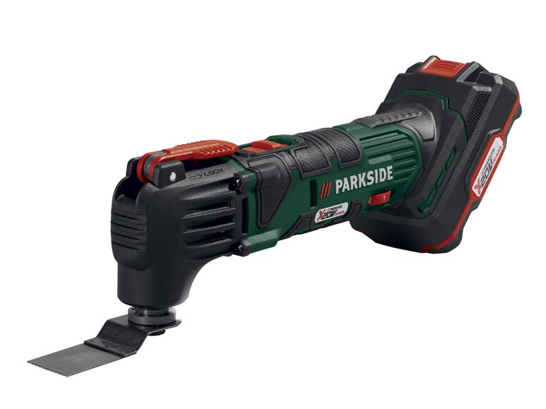

Allen key blade changes on a multitool would be a deal breaker for me, too much faf.
Is it too much of a faff for sporadic DIY use, though? My first multitool (the original Fein, bought in the mid-1990s) came with an Allen key mounting and I was happy enough with it - possiblhy because there was no alternative available (in fact there was the Fein, or nothing).
Fein #2 had a semi-QR blade mounting which meant I didn't have to go hunting for an Allen key set every time I changed blade, but by that time I was carrying a small folding Allen key set in my tool box or tool belt as other tools such as my circular saws had gone over to using Allen key blade mounting bolts so...
I can't say it's would be a deal breaker for me because a blade goes on and often stays on for a few days. If I were changing blades every 5 minutes, then it might well be, but I find I don't. And if it saves money?
I have to agree. Today at work I had to adjust the angle of the blade on my Fein about 5 times in a period of 15 minutes. Pulling a lever rather than using an allen key was significantly faster.
