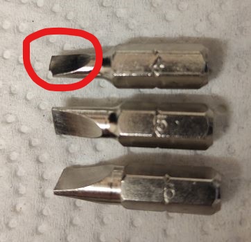

Yeah, none of my bits have got any quality ID stamped on them.
I've got the following bits.
Set 1: T10, T15, T25, S4, S5, S6, PH1, PH3
Set 2: T10, T15, T20, T25, T30, S5, S7, PH1
Bosch Set: PH0, PH1, PH2, PZ1, PZ2, S4, T10, T20, HEX4, HEX5
Socket Set: 4mm, 4.5mm, 5mm, 5.5mm, 6mm, 7mm, 8mm, 9mm, 10mm, 11mm, 3/16, 1/4
This one is damaged:
Throw it away - damaged bits can damage the screw heads, slip off screws or break and you run the risk of injury when any of those things happens

I think you can assume the silvery looking ones are unsuitable
the matt, dark ones may be correct. Are they thicker and heavier?
