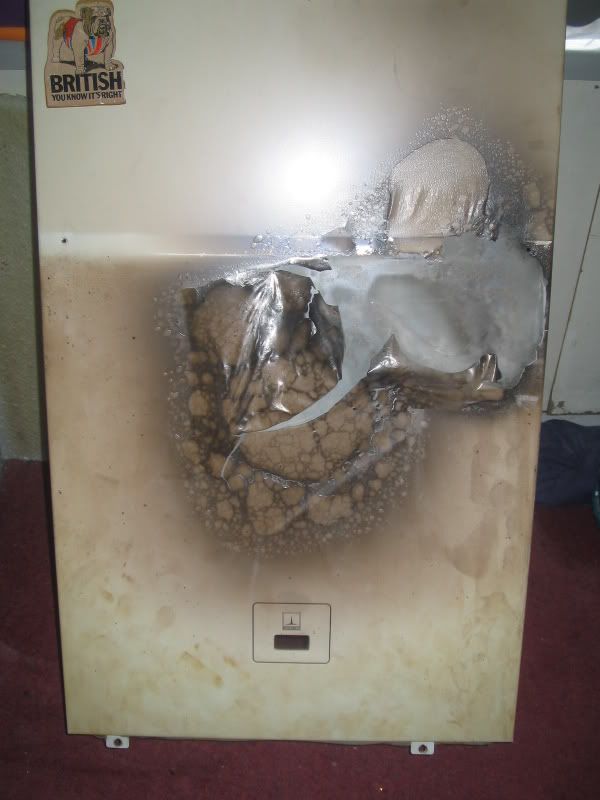

our bathroom boiler caught fire yesterday, sort of lucky it happened during the day rather than at night when asleep, it hadnt spread yet so i was able to put it out by turning off the boiler and then hosed it down with
the powder extinguisher.

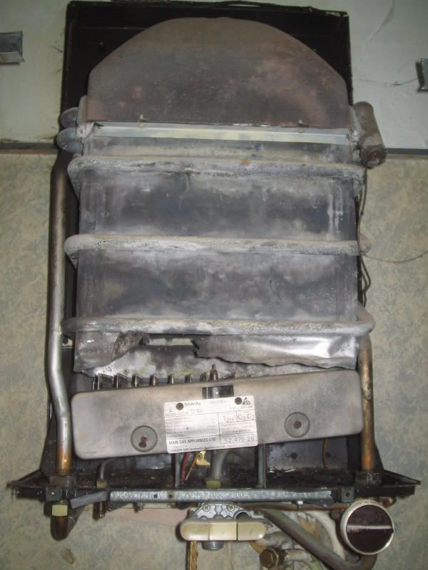

anyway i'm just wondering if anyone can tell what type of boiler is it from the pics below?,
it's a old one made by thorn, i think it's model no is 72-10.

It looks like a multipoint instant water heater, but when did you last have
it serviced, doesnt look recent.

Could be an old main medway, although it looks like a Thorn logo on the front casing, whats left of it.
Strangely, recently, I was called to a new customer who also had had a boiler fire in the bathroom, an Icon combi in this instance.
I think the data badge is a bit of a give away, Main Avon multipoint GC # 52-476-26 :LOL:
yeah it's a very old boiler that really should have been replaced , it only heats the water to the bath tub and basin, the shower is separate and is electric and then we have a worcster combi in the basement that heats the rest of the property.

The picture highlights the reason why folk shouldn't paint the casing of their boiler or if situated in an airing cupboard, why they shouldn't stack their cloths round the boiler..
