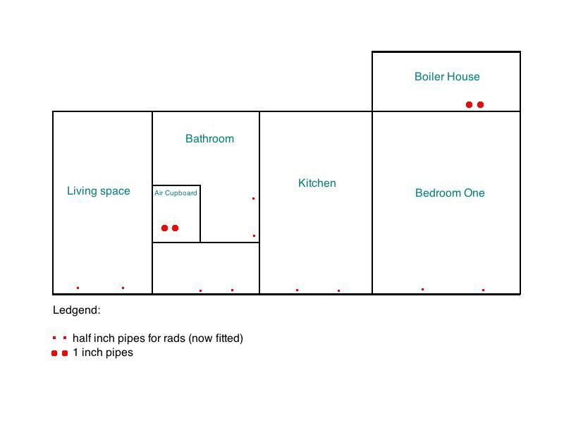

Thanks. I understand the typical layout but the only exposed pipes in the whole layout are two 1-inch pipes in boiler house (primary flow and return for boiler to be fitted to) and two 1 inch pipes protruding out of the airing cupboard concrete floor. That's it. What I'm presuming is that the flow to radiator pipes tee's off under the concrete. Does that make sense?
Ok, I've tried to sketch what's going on. This picture shows The pipes as they are.

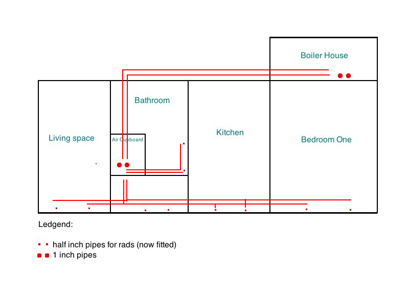

and this is how I'm guessing (!) the pipes are layed out under the concrete.
If they are I will simply dig up a small area of the concrete floor in airing cupboard to expose where they tee off ond re-do the pipework to incorporate motorised valves right?!

If you find the Ch flow and returns in the airing cupboard tee'd off then it's been piped up wrong. Until you find them can not go any further on this thread. From your diagram it looks the most likely place. Even though you say it's got 'white insulation?' I would not be happy unless I'd have done an air pressure test.
Just use a vacuum cleaner to suck air through the various ends to identify what is connected to what.
If there is an under floor connection between the primaries and the heating it will become apparent.

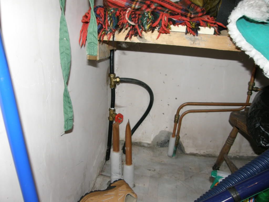

Hi all.
There is DEFFO no other pipes in the air cupboard other than these:
the two half inch pipe in background are hot and cold supply going down and through to the shower.
The two 1 inch are for the hot tank inverter coil.
