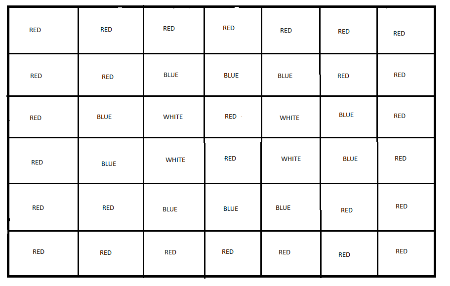

Hi guys, I want to assemble a panel of lights of different colors for the lighting of my living room
The only thing I know of electricity is that: there are different cables for different resistors for different
voltages according to use.
I have the idea of order of LED lights in a square aluminum board, but more than that I do not know. Also I
want to connect the maximum number of LED lights possible without overloading the three drivers.
I currently have 3 types of LED lights: white, red and blue. The technical detail of these is as follows:
List of my leds with electrical technical details:
- 50 (quantity) x 3w (watts) cold white / 3.23.8v 700ma
- 50 x 3w red / 2.22.4v 750ma
- 50 x 3w blue 445455nm / 3.63.8v 700ma
Also I have:
- 150 x pcb stars of aluminum
- 3 x 50 watts drivers INPUT AC: 85/265v50/60hz AC: 0.8A OUTPUT DC: 24-38V DC: 1.5a+5%
10C*5&*1W
Pic sketch attached
I hope someone will agree to help me.
I forgot the voltage of my country: is 220 v at 50 hz, C and L plug
The DC 24-38 v
The driver aren't manually changeable
Why did you get those particular drivers?
Do the LEDs have wires, or do you need to solder them?
What are "pcb stars of aluminium"?
(Maybe post photos of the components?)
The best way to power a large number of LED elements that all have the same current requirement is to connect them in series and suppley the series string from a constant current source. To ensure failure of one LED element does not blank the whole string each LED element should have a Zener diode connected across it. The zener will not conduct current if the LED element is conductng but will conduct if the LED element goes open circuit.
50 white LED elements at 3.6 volts per element would require 180 volts at the output of the constant current source irrespecting of the current it was supplying to the string of LED elements
A lower voltage would be safer
10 white LED elements at 3.6 volts per element would require 36 volts.
The constant current through the string can be provided by using a 40 volt supply and a resistor in series with the string. The LED element take 36 volts leaving 4 volts across the resistor. For a current of 700mA the resistor would have to be 5.7 Ω and 3 watt.
More accurate calculation and possible adjustment of the voltage to fine tune the current would be needed.

Now we have to think about the power supplies. Why did you get those ones? They have a 1.5A constant-current output, but your LEDs want only 700 mA. The easiest thing to do would be to get power supplies rated 700 mA. If that's not practical it may be possible to wire the LED chains in parallel, but there are some subtleties to doing that.

Thanks for your answer @endecotp, I buy these drivers only for his 50w, I have no experience on voltages, milliamps, etc.
See if you can find any that are better suited to the LEDs you have.
To be honest, I think that properly soldering the LEDs onto the bases, so that they are in good thermal contact, will be a big challenge for you if you don't have surface-mount soldering skills....

I think weld the stars to an aluminum plate of 18x20 centimeters with 4 millimeters thick, it would be better a higher thicker?
Weld aluminium? Not something I've ever done. It might work. Personally I'd glue them.
Check if the base of the star is connected electrically to either the + or - terminal. It probably isnn't, but if it is, the bases need to be insulated from the panel.
