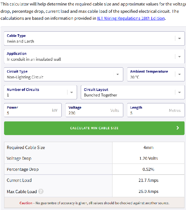

(1) Calculations that show that 4mm² cable is required
(2) An opinion posted by a person with a history of posting misleading opinions
Which to believe .... (1) Calculations that show that 4mm² cable is required
The calculation you present shows that 4mm² cable would be required if the cable were installed using 'Method A' (enclosed in conduit in a thermally insulating wall).
Why did you choose that installation method for your calculation?

Worth considering two 20 Amp 4mm radials to the island.

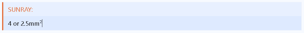

I was a little surprised at the post as my initial reaction was 2.5mm² should be plenty. In fact I penned this:
However, knowing Bernards usual accuracy, rather than make a silly fool of myself I used my head did this check:
So indeed our hallowed regulations indicate 2.5mm² is not large enough, in fact in the situation 2.5mm² is demonstrated to be too small for the ring circuit too.
Because it is closest to the cable being installed in a duct under the kitchen floor
""insulated stud wall cable NOT touching plaster board"" would require 6mm²

According to those calculations, it would mean that 4mm² would also be required for a 32A ring circuit so a ring circuit is pointless.
A 4mm² radial could have a 25A MCB (if available for CU make) so one would probably suffice.
2.5mm² 16A radials would also be acceptable.
So Bernard was right saying two radials with 4mm² and 20A (or 25A) might be better - that is if 40A (or 50A) is required for an island.
All this, of course, assuming method C is not possible.
