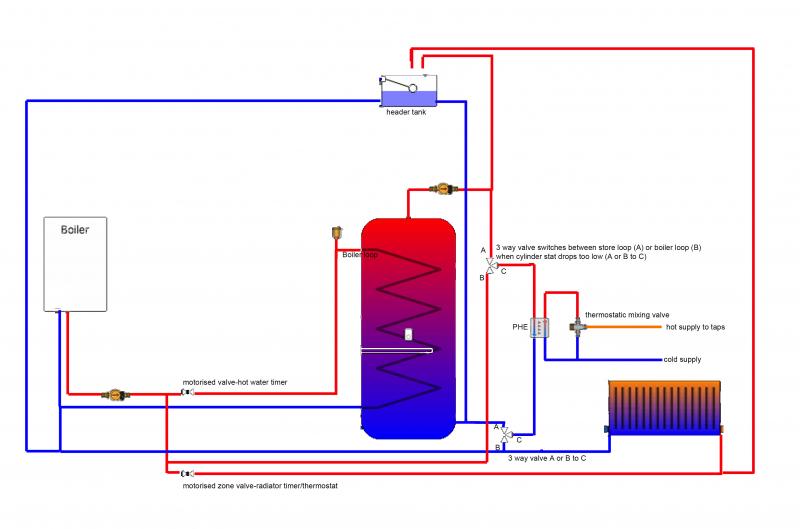

And I think this is nearer what you are looking at - again ignore the TMV on the boiler loop. I think I drew that for an old thread here where some ideas were being tossed around.

Thanks SimonH2, that's given me a lot to think about. However, I was intending on keeping the boiler and radiator configuration as it is, and have the boiler loop running through the internal coil in the cylinder as it currently does. Then, rather than fitting flanges or removing the immersion, I was thinking of simply using the current cold water inlet at the bottom with filling supply from the header tank, and hot water outlet at the top with expansion vent to the the header tank to create the separate pumped loop around the PHE just to heat DHW (see diagram). This would be simplest, as we have a LOT of radiators aswell as towel rails and underfloor heating on a separate zone valve and controller that probably wouldn't benefit from the thermal store. I was then thinking of using two three-port valves either side of the PHE so that if the temp. of the water in the store got too low, the PHE store loop would be bypassed and switched over to the boiler loop directly (e.g. like a combi-boiler). That way, if we're using a lot of hot water and the tank goes cold, we switch over to instantaneous heating from the boiler loop instead to temporarily maintain the supply. What you think?
I know very little about thermal stores, but wouldn't that gradually mix the water between the two loops? I suppose it might not be too much of a problem if the cylinder water had inhibitor in it. It would gradually equalise the levels in the two attic tanks though.
EDIT: I'm sure I didn't see that diagram before, have been having problems with my internet though. Anyhow, I now see you only have one header tank. That'll teach me to post so late at night :confused:
Can't see the point of the three port valves personally. Just put a TMV on the plate to keep the domestic water at a sensible temperature.
If the cylinder temp drops too low, then switching to the boiler will not help performance.
If you want to prioritise recovery to the store then wire the heating zone valve through a relay so that the store can shut the heating off if the temp drops too low.

What you are not considering - and we can't tell form the info given so far - is that the coil of the cylinder you have might only be absorbing 4 or so kW of energy from the boiler as well as being scaled up quite badly.
I really wouldn't bother with the 3-port and heat the cylinder directly as has been suggested and get the full output of the boiler.

I'd say, forget the complicated switchover arrangement - it gives you all the failings of a combi, plus additional complexity. It also means that you lose the separation that is (IMO) the only reason to consider staying indirect - because a large cylinder does need a large quantity of inhibitor (check the manufacturers data sheets to find out how much, you can't go off the "enough for a large system" statement on the packaging).
Going direct will allow you to use the entire boiler capacity to reheat the store. Not only that, but reheat will be top down if you design the system right - so you don't have to wait for the whole store to reheat, just enough to supply your immediate needs.
Yes, fitting extra flanges will be required. I'd suggest as a first measure to see if the immersion heater will unscrew. If it will then that gives you a large hole to access the insides of the cylinder by and you can fit proper flanges - should be a doddle.
If you have a mix of rads and UFH - then consider whether it's possible to separate them. The UFH will quite happily run off the "lukewarm" water from part way up the tank, while running the rads from (say) 2/3) of the way up.
