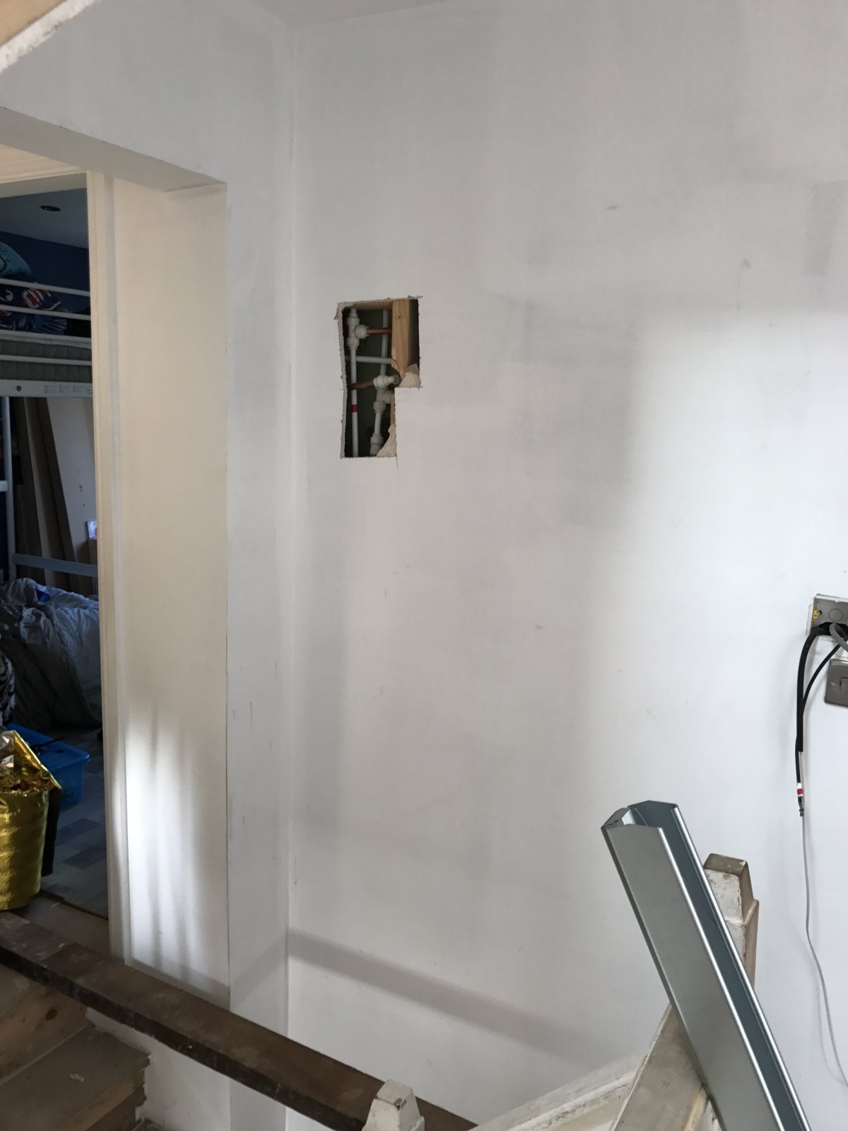

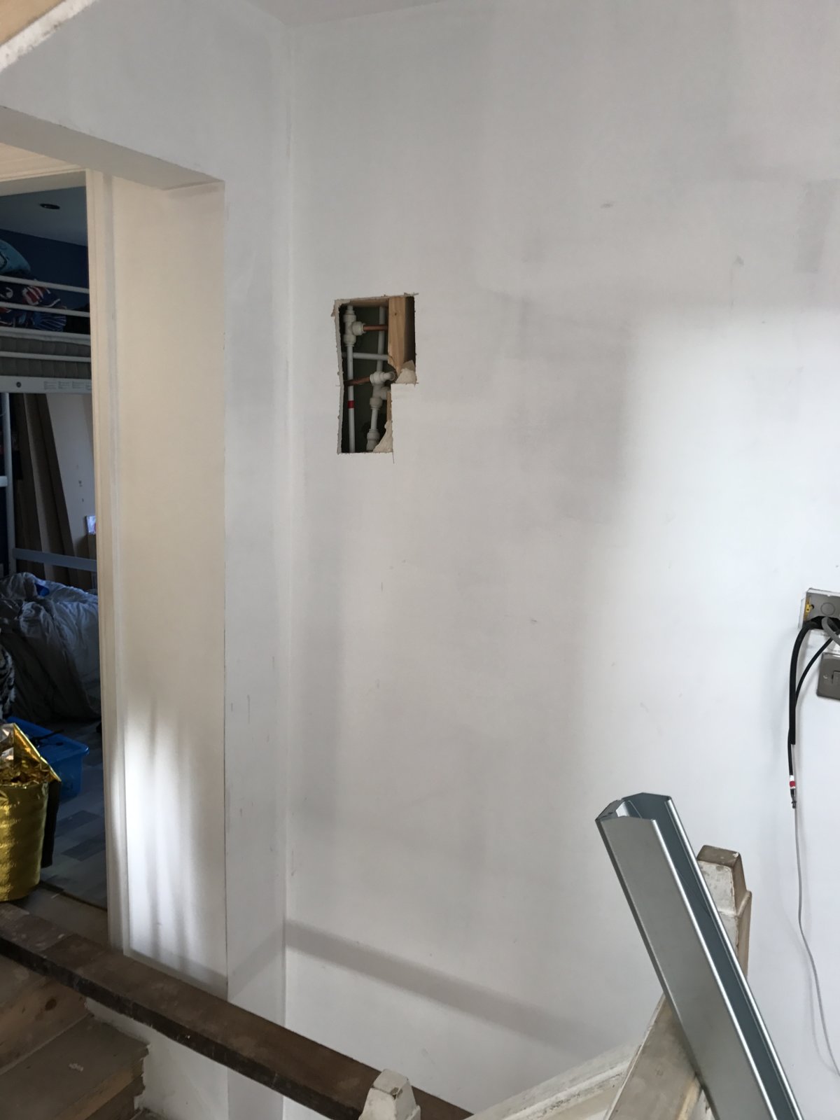

Plastic pipe has it limitations,any one interested in replumbing 200 apartments to provide a heating and domestic supply leak free environment.
After the initial 200 properties,there are another 2700 properties needing attention.Propertys are 14 years and suffering intermittent flooding/heating failure from poor plastic fit in walls,floors ceilings etc.
problem is existing pipes not secured and inserted push fittings just relying on other fittings to create some rigidity which is impossible and the push in fittings have dropped and **** out out water.
plastic plumbing thank you ££'£
