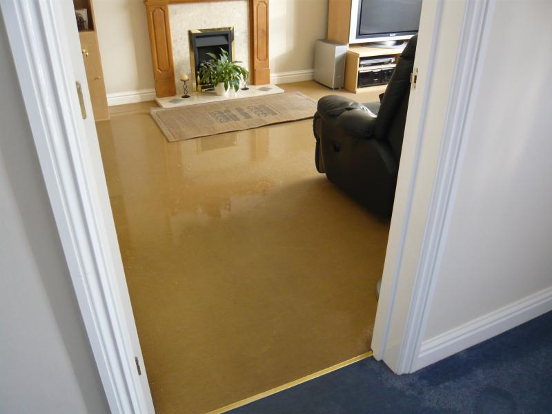

I'm a DIY'r and have always used copper, except when advised that a electrical break was required in the copper pipework feeding outside taps, duly fitted the suggested push fit plastic iso valve.
Valve assembly failed, pictures show the story:
Not a laminate floor, carpet under water!!
Head assembly failed
This had been fitted in accordance with instructions, unit returned to manufacturer by rep, recieved a good will gesture payment from them towards the damage, use with caution!!!!

but tell me, did you use the securing clips?
I cannot see them in the 2nd picture did you remove them?
I fitted what was in the pre-sealed packaging, the whole assembly was cut out complete with pipe stubs and sent for testing along with the head.
The suggestion was that frost caused a ice plug to travel from the tap to the iso valve and force the head off.
Their was no mention of any minimum working temperature or risk of frost damage, in fact the contarary in their web site, ideal for caravans etc

No it hadn't - there are no collet covers or collet clips.
[url=http://www.johnguest.com/linkpages/TechSpec9.html]John Guest[/url] said:
Use of collet covers or collet clips on fittings recommended.
Also, you let it freeze.

Do you use collet clips to hold the actual valve secure in the fitting :?:
All I can see is another failed carp plastic fitting,
The head assembly failed. Collects, which are not essential, secure the pipe to the fitting, this was not a failure of the pipe seal mechanism.
