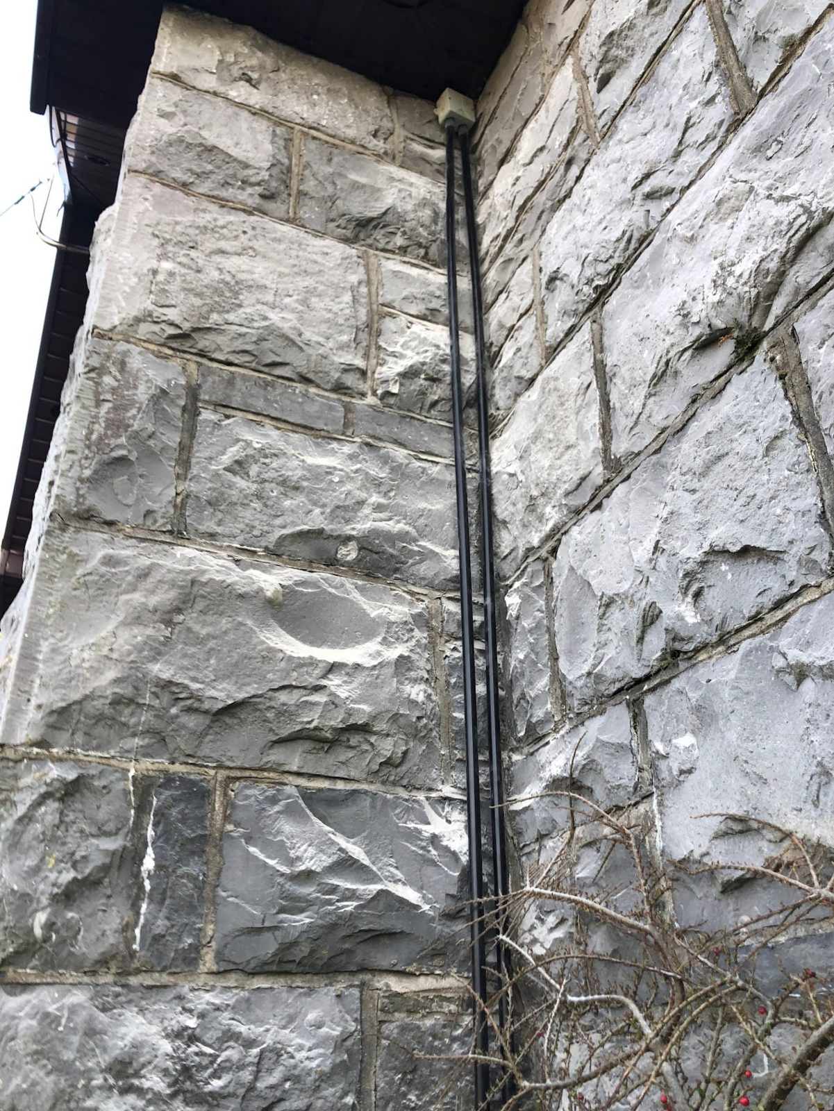

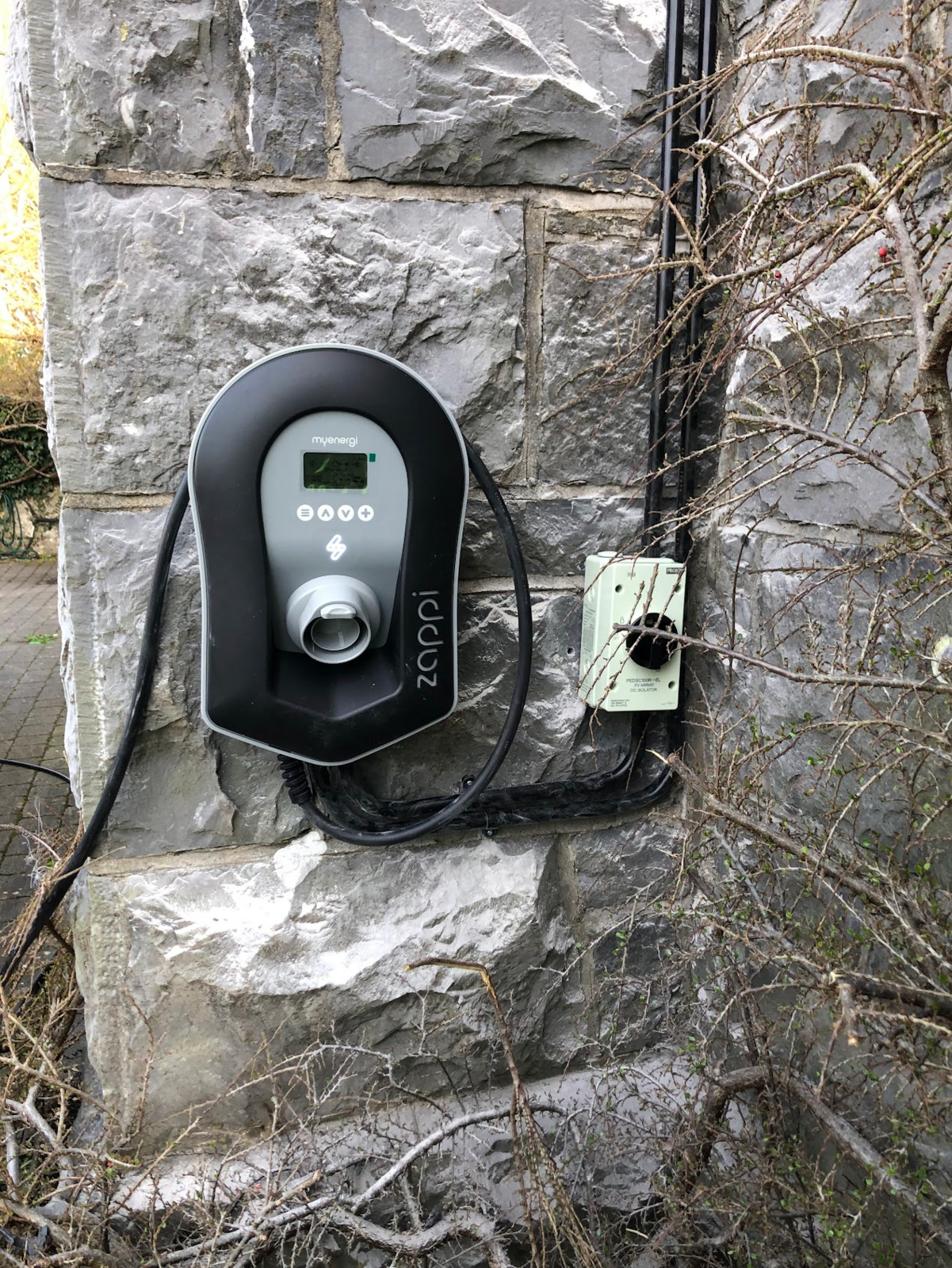

We have an EV charger installed. Both power and 2x Ethernet cables were run from the consumer unit, through the attic, out a hole and down a outdoors wall to the isolator and charger. The outdoor section of the run is shown below:
The OBO box is ip65 rated and covers the exit hole from the attic. The power and Ethernets are separated and sent down two 20mm conduits. One conduit with the power terminates at the isolator, the other continues to the charger (Note, the conduits are yet to be clipped).

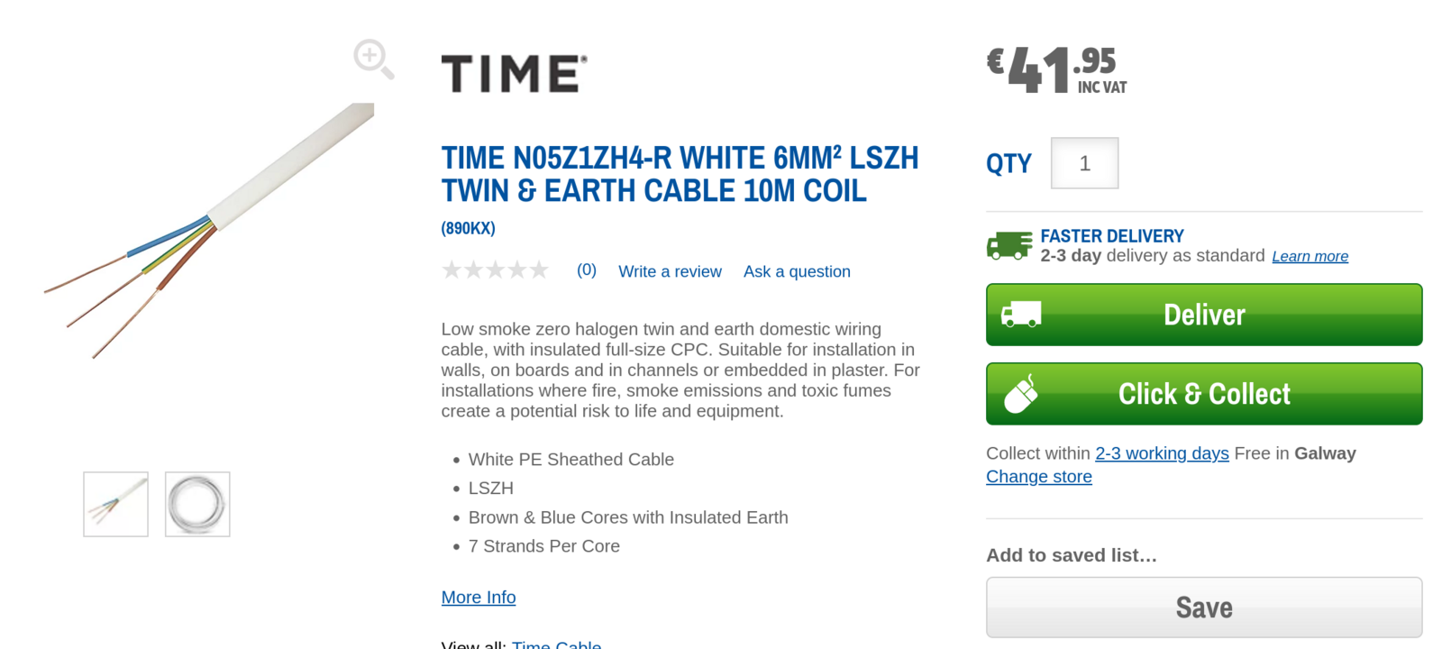

6mm sq twin and earth is used to carry the power, and goes from the consumer unit to the isolator outdoors with the only break being at the isolator.

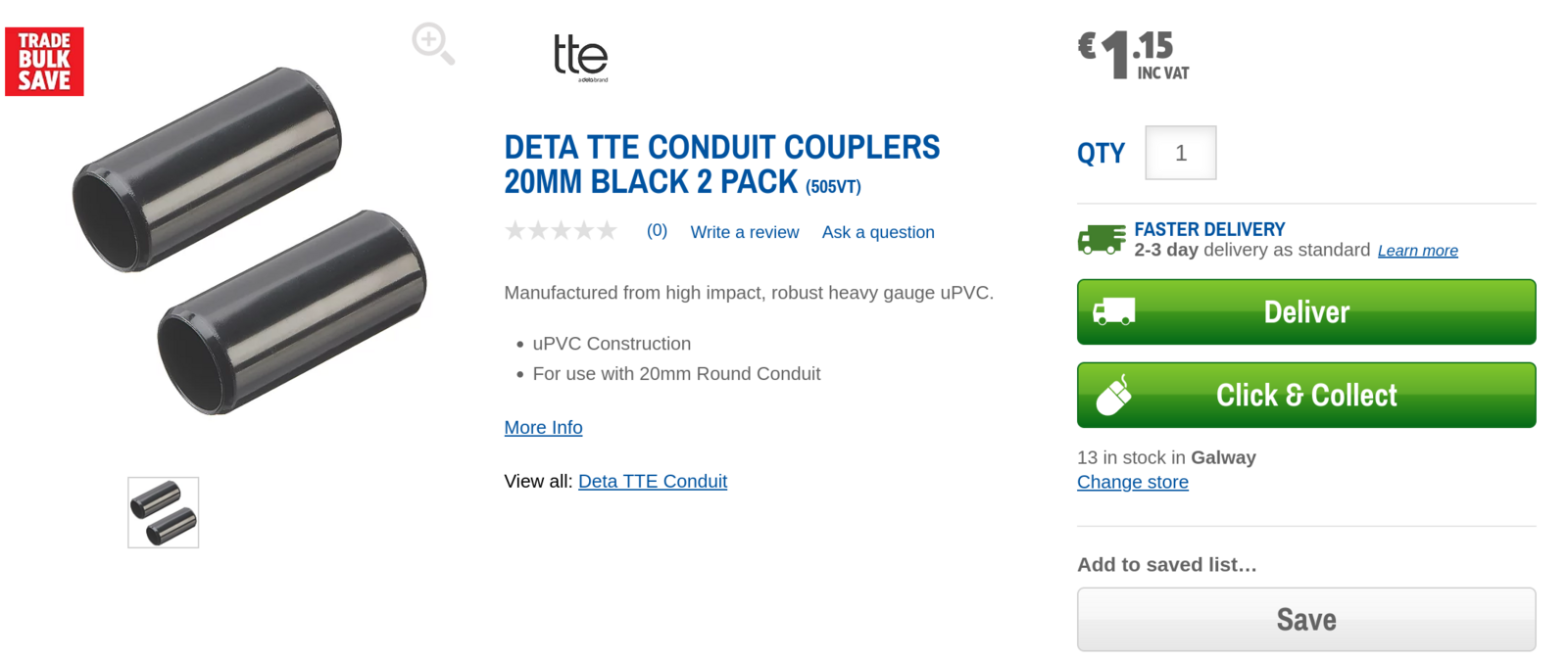

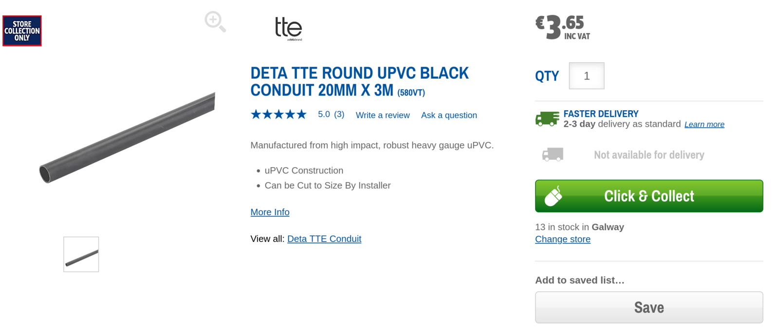

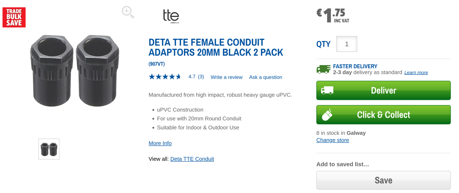

The conduit and connectors used were these from Screwfix:
My question is this: Is this cable management (connectors, conduit, etc) suitable for this set-up? My worry is that this connectors are not weatherproof enough, but im not sure what the alternative is for twin and earth. An electrician friend is going to give it a look over before the final connection, but I would like to have my ducks in a row before I get laughed out of it and put work on him fixing it.

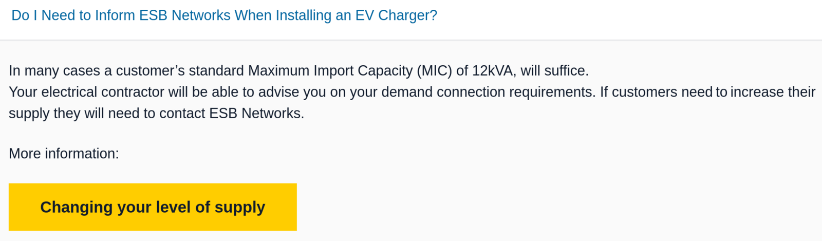

Thanks for the response ericmark. I will discuss these concerns with my electrician friend. With regards the DNO notification, my understanding for my situation is that this is not required (see below)
The Zappi chargers CT clamp on the household mains live feed allows you to keep the overall load under the households main fuse rating.

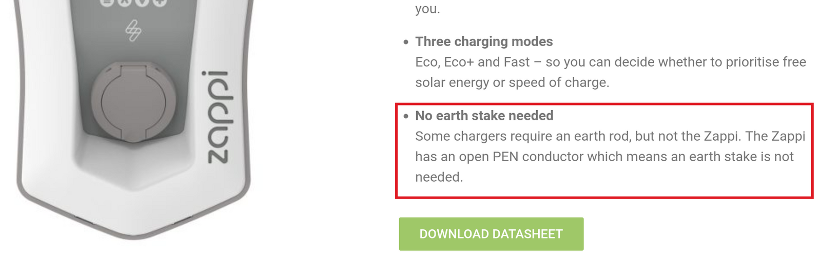

With regards to the earthing system, the Zappi has a PEN testing function which removes the requirment for an additional earth rod.
I will bring up these points along with the Local Authority Building Control issue with the electrician.

An armoured cable might have been more appropriate for the outdoor section, but my concern would be that left-hand conduit, which appears to enter the top of the isolator. Entering via the top, any water which gets into the conduit, or runs down the outside, will find its way into the isolator.
Water, getting to the outside of the PVC cable, in the conduit, is not necessarily an issue.
Hituff would have been a far better solution and entering the isolator at the bottom is infinitely better

Thanks for the feedback. Entering the isolator from the bottom rather than the top is a better idea alright.
From your comments, I am leaning towards stripping out the twin & earth & conduit and replacing it with SWA.

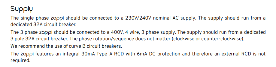

From reading the Zappi EV charger manual, it specified that an external RCD is not required.

Hi-Tuff cannot be used as it contains PVC. All cables must be to a minimum of Dca, -s2, d2, a2.
The poster cannot however install this himself though. These are Restricted Electrical Works which may only legally be carried out by a Registered Electrical Contractor. This does not only mean the final connections.
I made a mistake with a Fusebox type B RCBO it was actually curve B not type B. But as said not required, and @Risteard has confirmed what I thought, you can't DIY anyway so not your problem how to install.
The dedicated RCD which switches all live conductors (generally achieved via an RCBO obviously) is required. The Zappi electronic RCD functionality does not remove this requirement. 32A wouldn't be my choice, however.
