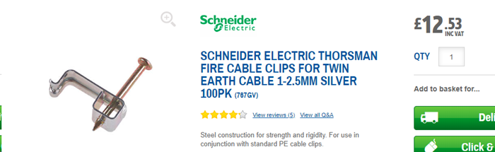

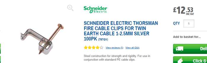

Does anyone know where to buy metal cable clips for 10mm² T&E?
I can only find up to 6.

Does anyone know where to buy metal cable clips for 10mm² T&E? I can only find up to 6.
Certainly not easy to find. You could always use buckle clips.

Of course you don't have to use metal clips along the whole run. Probably just every couple of metres (or more) would stop it falling in a fire.
Out of interest, is this domestic? Where would a 10mm² cable be installed where it could fall in a fire and be a hazard to the firemen?
Indeed, and a don't see why they would have to be purpose-made metal cable clips. Anything metal that would prevent such falling (e.g. metal plumbing saddle clips), not necessarily normally even in contact with the cable, would presumably satisfy the requirement?

Quite so - and, as I said, it doesn't necessarily have to be as crude as 'a couple if nails'. There are plenty of plumbing and general hardware hings that would do the job ... and, as I also said, if one actually feels the need to use some 'electrical' product, there are always metal buckle clips.
