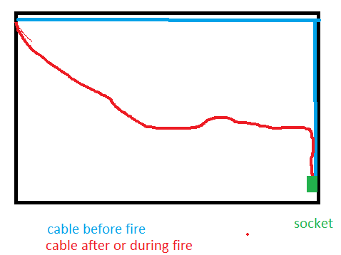

Any cable around the edge of a room or in a ceiling where it doesn’t run thru joists is a risk to a fireman
That's what people say but, as I said, I find it hard to picture many situations where it would be a problem - a cable going up one side of a door frame, across the top and then down the other side would be one example I can think of. However, in general, any cable goes from somewhere/something to somewhere/something else, and those things will stop the cable falling u less there is structural collapse - in which case I would have thought that the fire-fighters would be dealing with much greater hazards than just cables.
Could you perhaps give some examples (other than up and across the top of a door frame) where the hazard you are talking about would/could arise?

I think you need to remember ceilings collapse easily. Cable has slack and then will hang down.
True, but, in my experience, there is very rarely enough slack to hang down low enough to cause any real problem. Indeed, rarely enough slack to prevent me cursing when "I need a little bit more" :)
I disagree with that, although often not installed for the purpose of fire rating, plain Gyproc WallBoard has a 30 minute fire rating which should be more than sufficient to eliminate the need for any special fixings above a ceiling.
so I would not have thought that even with total collapse of the ceiling the cable would 'droop# down far enough to get in the way of fire-fighters or others?
That depends on the cable remaining fixed to the top of the wall at both sides of the room.
Indeed - but, as I said, a cable will always go 'from somewhere to somewhere else' (holes in masonry walls, accessories etc.). If it becomes detached from one of those 'ends', and is not otherwise contained, then it will obviously 'fall' but (a) assuming it's above a ceiling, then one is then considering at least two major things having gone wrong (collapsed ceiling and disconnection of cable and (b) if a cable falls and 'dangles' because one end has been disconnected, then I would not thought it would represent all that much of a (mechanical) hazard to fire-fighters (or others) - I would have thought that it's when a 'loop' (facilitated by slack) 'dangles down' that there is an appreciable risk of 'entanglement.

If the fire is sufficient that the ceiling is down, the room is going to be unsuitable to use as a walkway anyway.
