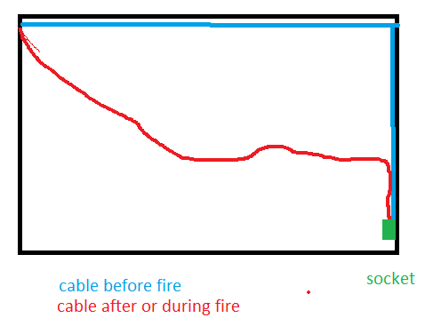

I don't really understand that diagram. I would normally expect the vertical drop to the socket to all be buried in a wall, in which case it would be 'supported' by it's entrance into the top of that wall (and also where it emerges from somewhere at the top right of the room), and therefore presumably could not do what your diagram is suggesting
.... or are you assuming that the wall, as well as the ceiling, has 'collapsed'? (if so, I suspect that the firefighters would have more to worry about than cables!)
If it was buried under plaster and the plaster failed due to the heat of the fire then the cable could easily "rip" itself out of the wall.
If the fire is sufficient that the ceiling is down, the room is going to be unsuitable to use as a walkway anyway.
The room may be free of fire ( extinguished or all fuel burnt ) and could be the only access route to persons trapped elsewhere. Making progress through a room filled with smoke, debris and zero visibility is very hazardous.
I would probably be inclined to regard that as 'barrel scraping', requiring multiple failures (albeit that may happen). Furthermore, I imagine that many would feel that they had satisfied regulations by clip(s) which were largely (or totally) reliant on being fixed to a plastered wall - so if the plaster 'failed', one could easily be back to situation you envisage.

I vaguely recall that the main incident that triggered this requirement, things had been hot enough for the concrete to start spalling. It's certainly not hard to consider plaster failing under that sort of heat. Even a cable that's free at one end can be a significant problem if you get caught up in it.

But in the case I can remember, and which I suspect triggered the change in regs, firefighters were working in a building (yes, another tower) where the concrete was already spalling from the heat - i.e. bits of concrete were falling off the underside of the floorslab above them. That also implies that the ceiling (probably plasterboard fixed to timber battens) had already fallen. Two unfortunate firefighters found themselves with fallen cables tangled round the valvegear of their breathing apparatus, were unable to escape, and sadly died. IIRC they were engaged in a sweep of the building to ensure that no-one was left in there - long after a normal evacuation should have finished. Part of the report's recommendations was to change the design of the BA to make it less susceptible to entanglement.
It's not unreasonable to apply "reasonable" measures to avoid that happening again - but there is some debate as to where that "reasonable" line should be drawn.
What appears clear (to me at least) is that we cannot assume that "anything above the ceiling" is automatically catered for by the ceiling lasting as long as anyone will be in the building. I also think that we may not assume integrity of the plaster holding cables in the wall. But both of these would need to be done on a case-by-case risk assessment - in a two story block of 4 flats I think it would be reasonable to assume the ceiling is still up and the plaster intact by when the building is declared "clear". In a tall tower block, that is highly unlikely to be the case. Also, in the corners of a room it may be less of an issue, but on a route likely to be used during/after a fire it would be more of a concern.
Then we might need to consider which is worse amongst different options. Take a typical flat with concrete slab floor slabs ... Cabling to the power sockets is likely to run across the ceiling and down the walls to the sockets. When the ceiling goes, it's unlikely that the cables will stay out of harms way - that could only happen if no slack AND they take a straight line route across the ceiling. So is it better that they stay dangling at random heights ready to entangle the BA of an unlucky firefighter - or is it better for them to fall to the floor and add to the general detritus they would already be expecting to have to negotiate ? One thing is for certain, unless the cables are fixed to the floor slab with fire-resisting fixings, they are not going to stay out of harms way when the ceiling comes down - so that perhaps outlaws the practice of clipping cables to the timber battens before the plasterboard is put up ?
EDIT: Also, these days, if the cables are clipped to the timber with fire-resistant fastenings, then as the ceiling comes down, it's going to try and pull the cabling down with it - possibly ripping it out of the walls before they would have fallen due to their own weight.
Or perhaps we rethink the fire resistance of typical ceilings - perhaps making them 1 hour (or more ?) fire resistant, which would imply additional construction costs (and maintenance restrictions).
