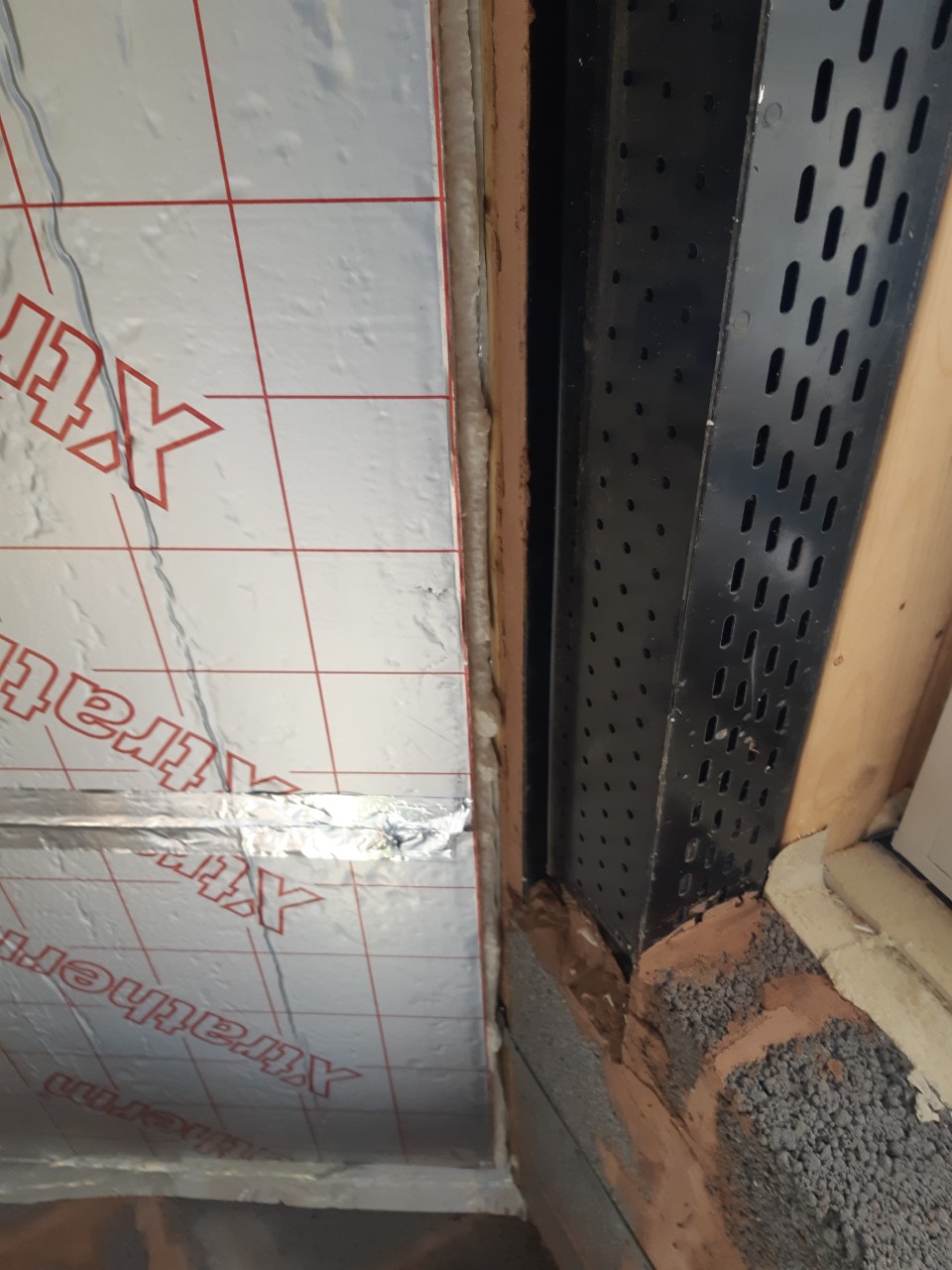

We don't have a set of Building Regulations and building designers that only legislates for those that don't mind a cold draughty house, nor do we have a set of Building Regulations and building designers for those that like to keep the windows firmly shut, all year round. Rather, we design and build robustly, so that the building will fare well under year round UK conditions, no matter the occupancy or the temperature outside.
My house is mostly mould free, bar from a tiny bit on the window reveal on the NE side, right where the missus keeps a box of stuff up against the reveal. It's not a 'problem' though. In fact, window reveals are one of the more difficult zones to keep mould free, because of the fact that it's already a heat-loss zone and the prevalence for condensation - and the fact that there is little room to insulate. Not such a problem with modern design houses though, thankfully. It's one of the reasons we now have a thermal break - i.e. no longer return the masonry into the reveal.
Reveals look like this these days.....
