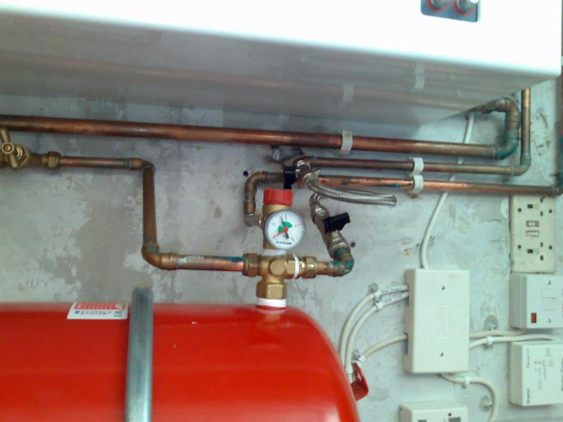

I just wanted it clear in my head what's wrong, so we can hit the conman hard with it all when we call him.
just to add to this...
I should be able to look at a new installation and learn from it, not see things like what in the pictures i posted!
If you allow them to come back and bodge it further (I would have no confidence in the work or the gas installation being done properly), then corgi/building control will not be able to investigate their installations. Sometimes they contact all the previous customers in order to check for safety.

Not entirely, they can be useful, but should NEVER be between the boiler and the safety prv and EV.
Is as GG pointted out, what I meant :oops:

Turning the valve on will not help the situation as one end is a non return check valve, and the boiler will still have no pressure relief valve or expansion vessel, as a result the boiler, radiator or any part of the system which is the weakest can exploded at any time.
****** didnt think of that! I'm going round and pulling the fuse!
I would tell him that if he isn't responsible you will phone Transco, who have the authority to disconnect the Gas supply to the property.
The only thing saving the installation from blowing a joint is a little trapped air in the top of a rad.
The rise in pressure due to the expansion of water heated by just a few degrees can be staggering.
Tests have shown pressures of 50 Bar or more have been reached just from warming pipework a little.
If he puts on the heating (that results in significant expansion volume) something will let go bigtime.
The boiler needs careful checking since it may already have suffered damage (AFAIR boilers are not even covered under the Presurised Equipment Directive so I doubt they are designed to handle pressures much in excess of 5 Bar).
With the odd cold night coming it won't take long before he has an even bigger problem :rolleyes:

I have pictures, i took more today before I left... will this stand as evidence?
mick.
closer clear image of filler.
Yes but try to make it clearer. It wasn't all that easy to work out what might be "backwards" from the prv connection in the last one.
Use a better camera too!
Then something like Photoshop can be used to put light into the murky depths afterwards so you can see what's what.
